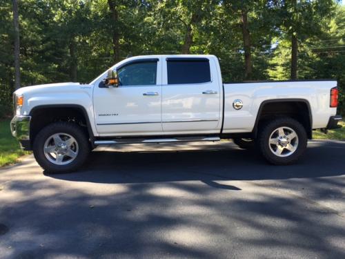

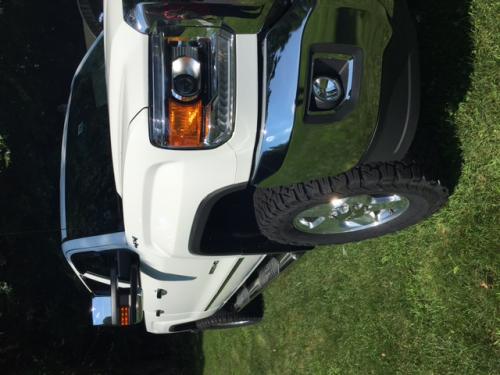

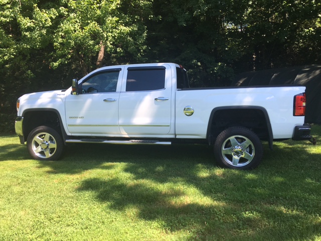

3.5" TC lift want to use stock rims and 325/60/20
anyone out there using the TC 3.5 lift and used stock 20s with bigger tires ..
ill need to use a wheel spacer for sure looking for tips or recommendations post-161129-0-94248900-1470331810_thumb.jpg
Does the truck in the pic have the lift? It looks good, I was thinking 3.5 or 4, the only way to know is mount one up and drop it down, turn to turn and you will know. I wouldn't trust any other way. I want the same tires you want, I had 325s on an Excursion and they look great. Those were 18s so these 20s will look great. So if this doesn't fit, and I would avoid spacers, you get to buy new rims.
looks nice! I will be in same boat soon. I am installing the Ready lift kit with new upper CA and tie rods. Same lift height, new fox shocks all around.
I like my rims and want to keep them but believe the back spacing will not be right, they say will rub on full lock but can use original wheels with up to 35x12.5.
There is someone in forum who put 35's on stock wheels and just cranked up stock keys all the way. Cant imagine the ride is too great...
Without a wheel spacer, I think you'll rub the sway bar or frame with the 325's on stock rims. A 35x12.50x20 or 295/65/20 should fit though.
I think either way you will still hit control arm on full lock. Even with 35 x 12.5...Only one way to find out! Lol
