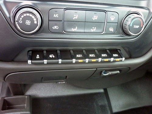

attachicon.gifd853e64d9587972cc5b975e6404df679.jpegif you have an LT you can do this
I have an LT but I only have 3 switches right there? Is that a new board you have to swap out?
Can you buy the rocker switch to replace blanks? how is the hookups for power on the back? Excited!!

You need specific rpo codes or you have to rewire from fuse panel under hood to x61a in floor board. I did it in about 4 hours. Soldering 8 connections on both ends and running with factory harness. I can build a harness and send it with a write up if interested. Better be comfortable pulling connectors apart and some decent experience. I have pictures from when I did it but it's no simple plug and play. Not bad, but not for the faint of heart
