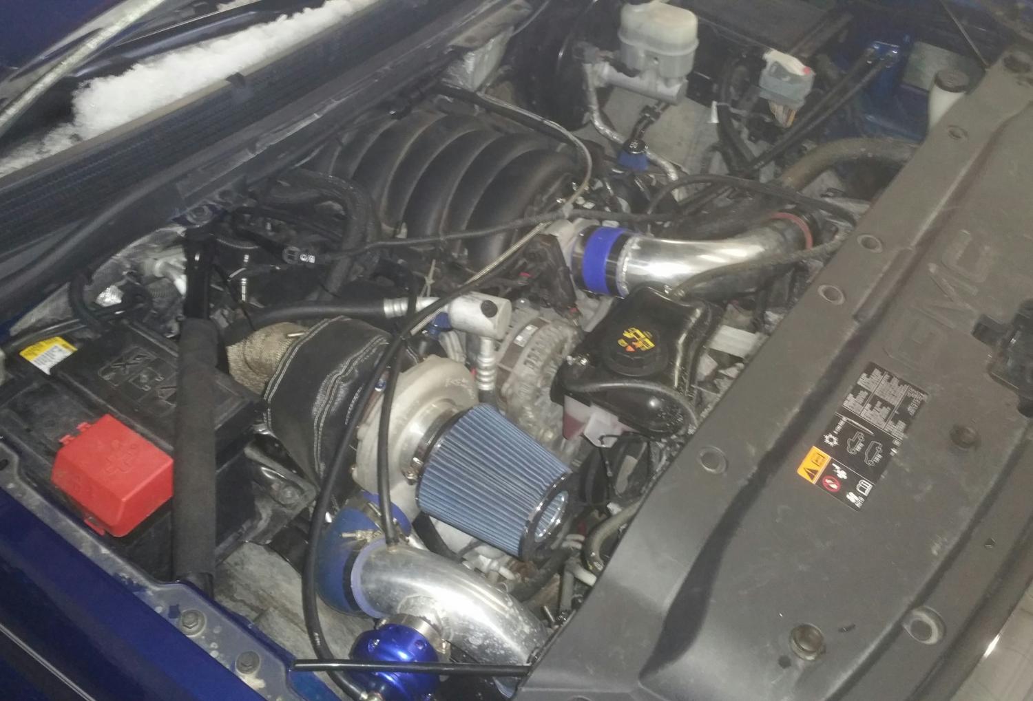

Turbo all the way!!! On 5 psi it made 440 whp 470 wtq on crappy gas no meth. I had it retuned on 10 psi and it's flat out rediculous. No dyno numbers yet on 10 psi though. I pulled on a 2016 DI Camaro like I was walking in the park.
Towing also is night and day. I've now got more power then the chassis can handle. Recently moved my shop and had a 14' HD 2 post lift, fully loaded 5' tool box, shop tools, engines, air compressor ect on the same load. Pulled it like a diesel.
Would you mind sharing some details?
Did you buy a kit or custom build?

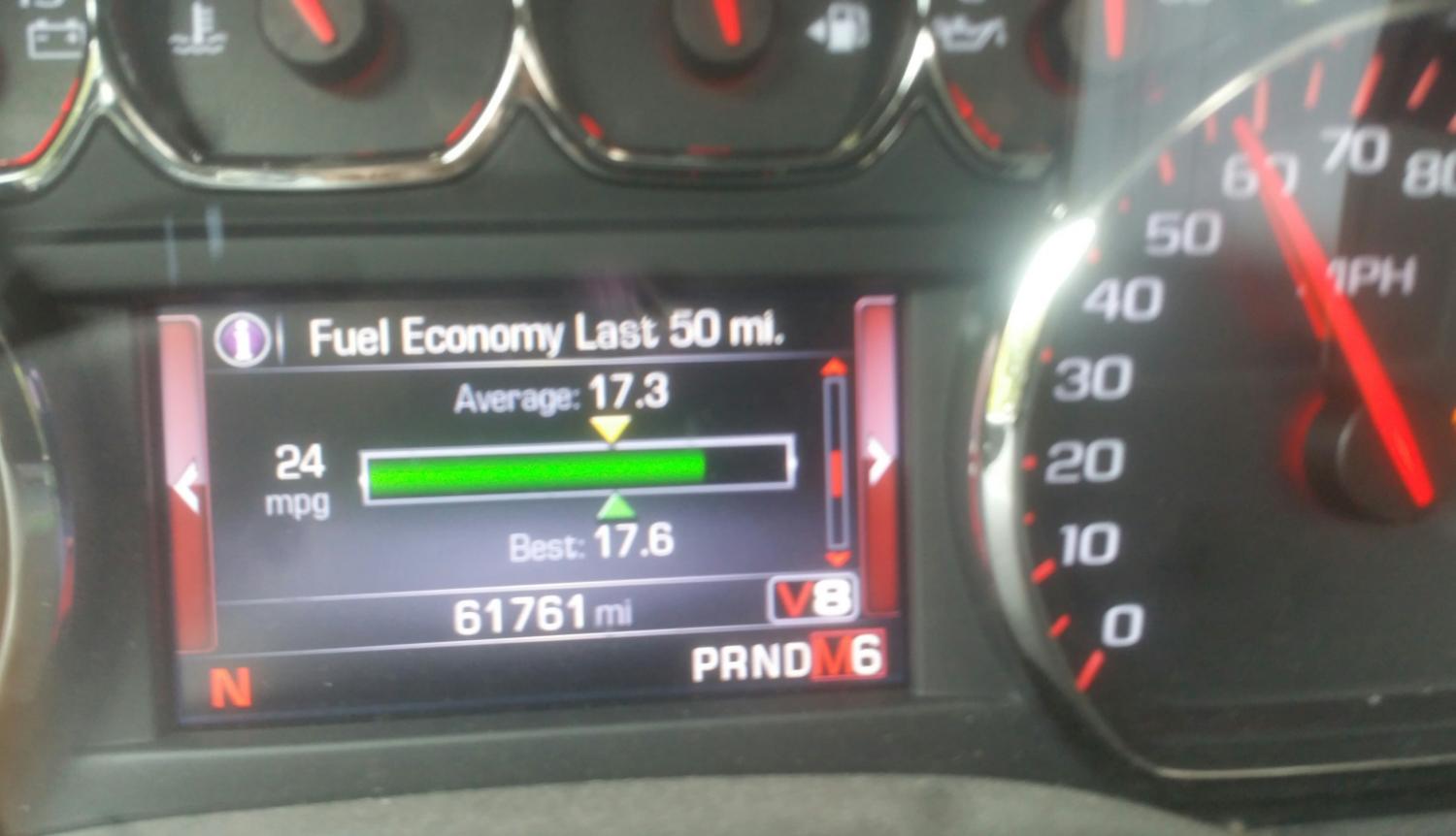

Surprised your fuel mileage is that low. I've turbo'd a few cars and usually get very close to stock mpg. One car was actually better than stock with the turbo.
That's city "miles" with me beating the snot out of it. This truck NEVER gets a break. If I baby it I'm sure 20 or close to it is possible. On the freeway I've seen 21 mpg for about 70 miles.
Truck is bone stock other then the turbo which is a s366. Built everything myself. 60mm wastegate, 50mm bov, 31x14x3 intercooler.
