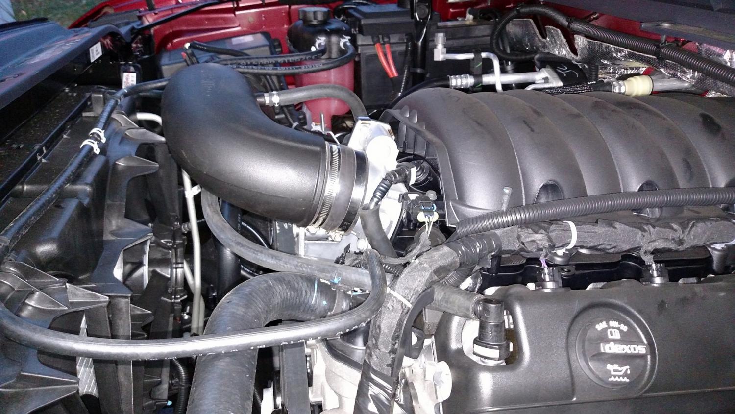

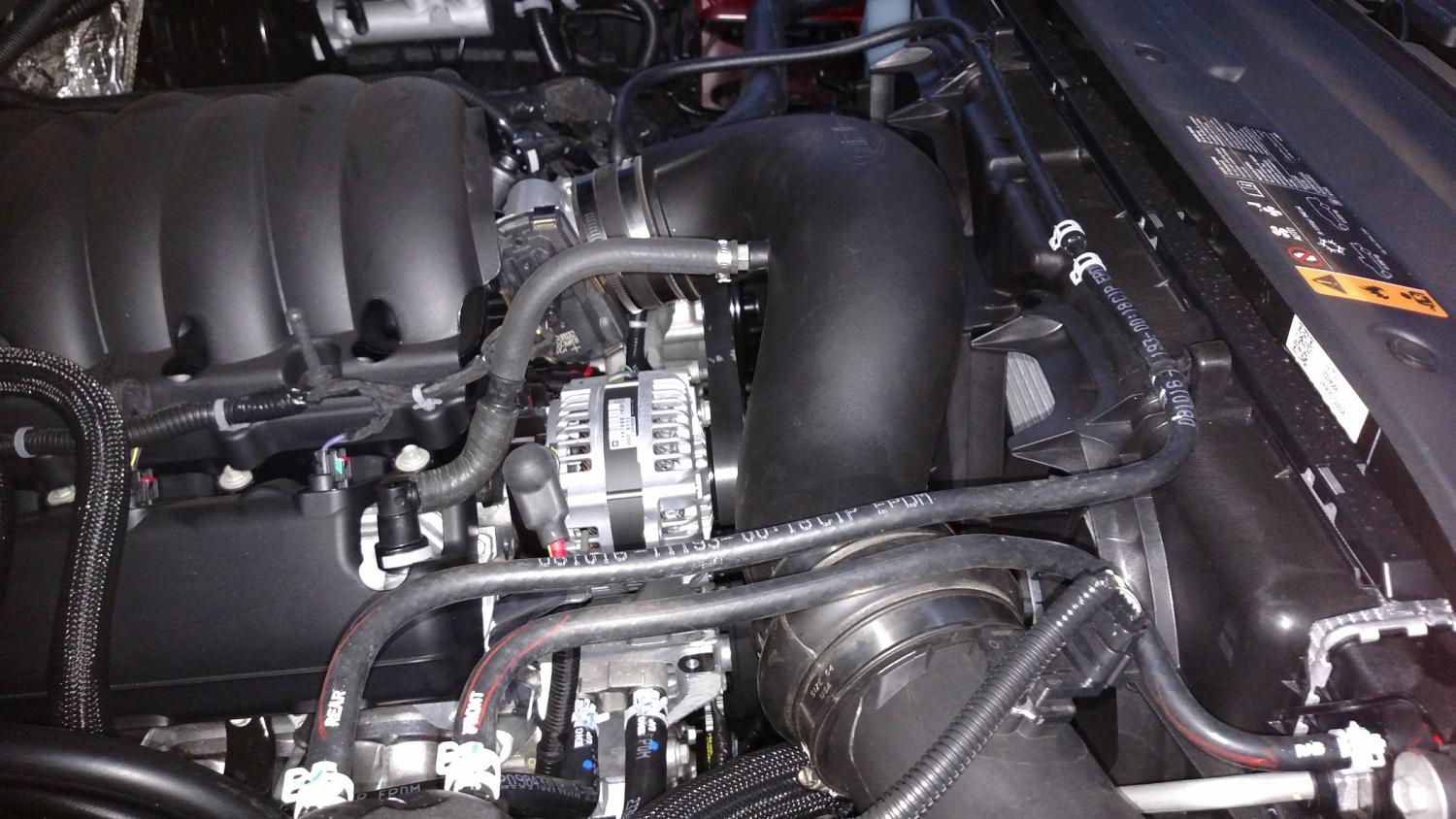

I have an airaid MIT from a 2011 5.3 silverado. Holding it up in the engine bay it appears as though it will fit on my new 2016 5.3. Except the new engine requires two breather hoses going into the intake tube instead of one.
The old tube has an unopened plastic boss on the bottom. Has anyone drilled/tapped this out to reuse the old style MIT on the new trucks? Just trying to avoid the hassle of selling this one and buying the new style if the only difference is a hole I could drill myself.

Thanks, no luck locating another nipple for the second hose. But a male qd connector from my box of air compressor parts looks to do the job.
Drill hole thru and tap to 1/4 NPT, locate nipple to hose barb fitting. (5/8" idealy)
most auto parts stores have required parts
then step up fitting 5/8 to 1/2
I found 3/8 to 5/8 couplers on amazon so I can use the npt nipples and hose I already had. Then I picked up 1 ft of 5/8 hose for the engine side.
INSTEAD of disassembling the engine side connectors though, I'm just removing them and sliding the hose directly over top the steel nipple on the valve covers. That way the factory breather hoses are still in one piece incase I ever decide to go back to stock.
all that was required was a little bit of heat, came right apart no damage to stock stuff easily replaced later
