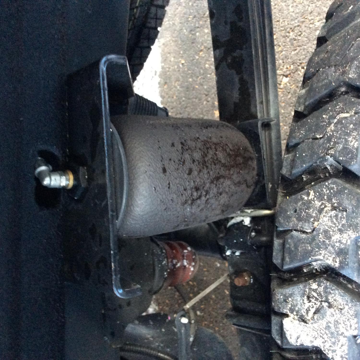

POWERQUEST290 Posted December 3, 2016 Posted December 3, 2016 Groutguy what air bags are you running with the magnetic ride? Looked online and standard air bags hit the control arm of the magnetic ride, so I got a set of timbrens and they still rub the arm even though they told me they wouldn't!
groutguy Posted December 3, 2016 Posted December 3, 2016 Groutguy what air bags are you running with the magnetic ride? Looked online and standard air bags hit the control arm of the magnetic ride, so I got a set of timbrens and they still rub the arm even though they told me they wouldn't! I'm using the Airlift Company Ride Control kit. It's rated for 2000 lbs. Of load assist. Because these bags are mounted inline over the leaf springs, it is not affected by the lift and it also doesn't interfere with the magnetic ride sensors. I'll take a pick for you, when I have a chance.
groutguy Posted December 3, 2016 Posted December 3, 2016 Here's a picture of the airbag on the drivers side. Lots of clearance for the magnetic ride sensors.
POWERQUEST290 Posted December 4, 2016 Posted December 4, 2016 Thant what i needed! Going to sell those timbrens and get that setup. Thanks
