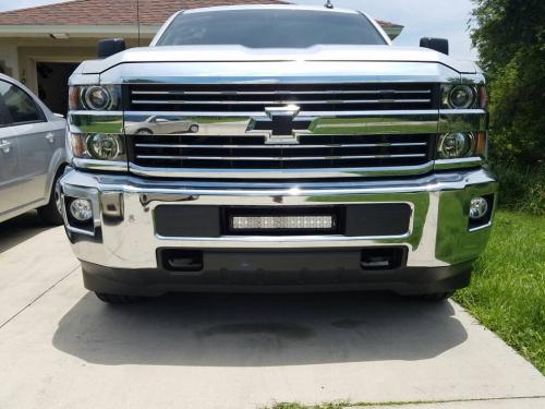

I did this on my 16 silverado, brackets were bought from Socal SuperTrucks

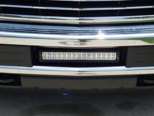

Installed with an 18in Vision X Lightbar. Happy with the way it turned out very bright looks stock to.

All you assholes do is blind the people coming at you with these ridiculous light bars.
I made my own bracket to mount a 12" single row led light bar just above the bumper and allows air to the trans cooler. I haven't seen trans temp increase at all. The one pictured above I would bet blocks enough air to increase temps. I would only run a single row if you plan on doing it.
