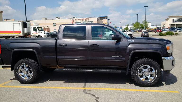

I run 35's with a 2" level on the front with no issues (turned up factory keys) post-84385-14816291418_thumb.jpgpost-84385-148162925219_thumb.jpg
