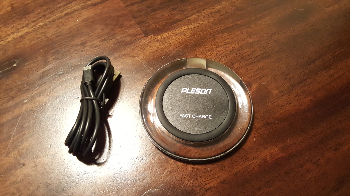

1. Bought this charger off amazon: http://www.amazon.com/Wireless-wireless-Sleep-friendly-Compatible-Qi-enabled/dp/B01D8D5NCA/ref=sr_1_1?ie=UTF8&qid=1486180739&sr=8-1-spons&keywords=pleson+fast+charge+wireless&psc=1 ($17)
2. Took it apart to get the wireless circuitboard out.

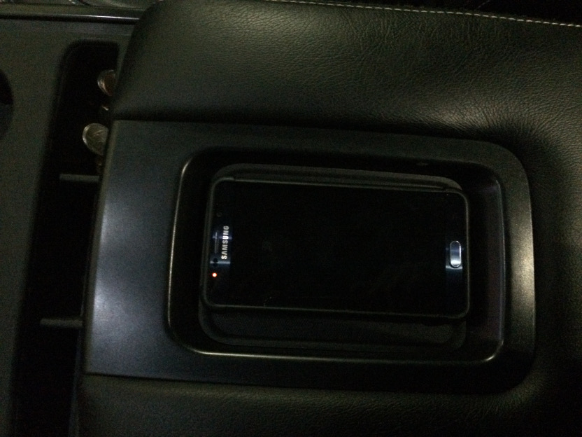

3. Removed rubber from top of console.
4. Cut hole in console to fit wireless charger.
5. Ran fast charge cable to fast-charge wireless charger and put rubber back on.
More pictures. Did you epoxy it in place? I just ordered the charger, I've been wanting to do this for awhile
No, I just used 3m automotive tape I got off amazon a while back. It holds it down well enough and doesn't slide. I have attached a couple pictures of how to easily take the charger apart.
- Remove the rubber ring on the underside of the charger and it will expose 5 screws.
- Unscrew them and that plate lifts off. I used a small dremel cutting tool to cut out the shape of the charger (Through the first layer).
- You only need to make a small hole for the microUSB on the underside of the console.
- Make sure you remove the plate on the bottom side of the console before starting. Hope this helps.
