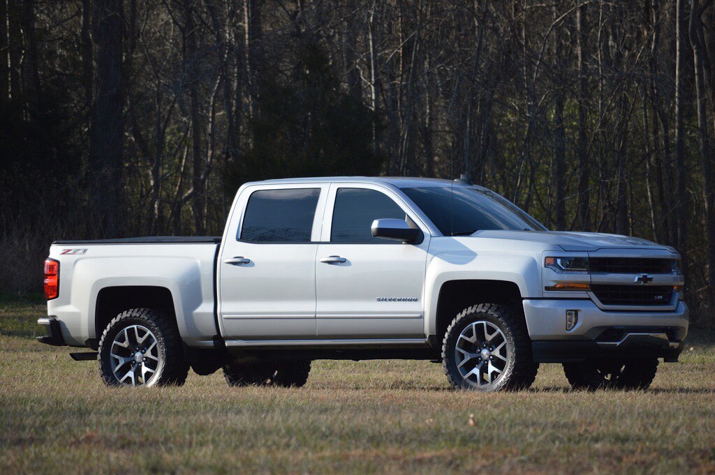

I've got a 2016 silverado with OEM GMC a/t 20s on 33x12.5. Mine rubs real bad on the UCA, but rubbed some with the stock tires that were on the wheels to begin with. Do you have stamped steel control arms? I've heard they are a beefier control arm, making rubbing more prominent at lock
Edited by Travis1024
Angles look very similar to mine with fox 2.0 coilovers with stock 20"s. I didn't adjust my coilovers and they brought up the front 2" out of the box. My rubbing isn't as bad but I noticed very early on and have been really careful not to go full lock in either direction. I also took it back to the shop for another alignment and everything was good. Gotta be the stamped steel arms being thicker/wider than the cast or aluminum.

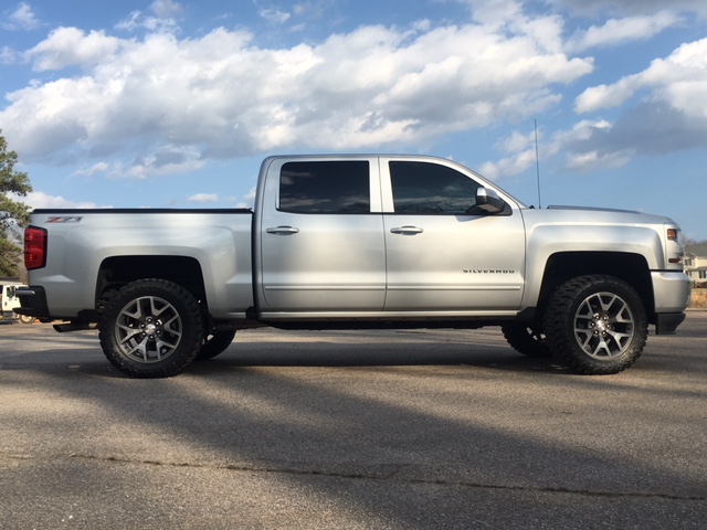

I wish someone would have told me this before I ordered my leveling kit, but keep in mind that lower strut spacers will NOT work with these stamped steel lower arms. The rounded edges/shape of the LCA will not allow for a flat spacer to sit flush.
No issues at all with the top strut spacers though :)
so i just need to swap it out for the top spacer and take the bottom one off and hopefully ill be fine?
That is correct! The kit i ordered was the 2.25 procomp level which came with both the top and bottom spacers.
Top spacer only gave me about 1.25 inches (couldnt use the bottom obviously), and then i did bilsteins all around with the front adjusted to 1.25 giving me 2.5 total.
I also did a 1 inch block in the rear maintaining about 3/4 inch or so of rake in the rear (which i wanted) but looks damn near level to the eye.
Long story short, if you did a 2-2.5 inch top spacer, you will be pretty spot on level! Below is how mine sits
