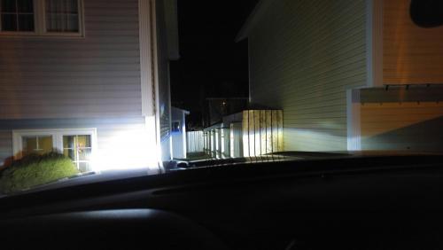

i adjusted the passenger side a little and its a little better. still unsure what those two big hot spots are above the cutoff though, they are both coming from the passenger side and its annoying seeing them up in the trees.
the bulb needs to be rotated 180 degrees. I read somewhere on here on a sticky that if that spot occurs, rotate the bulb
