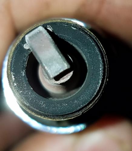

Pull that plug and post a pic. if it looks like this one we may have some oil burning issues.

Ok i couldn't handle the suspense, this is at 35k. This one looks good
