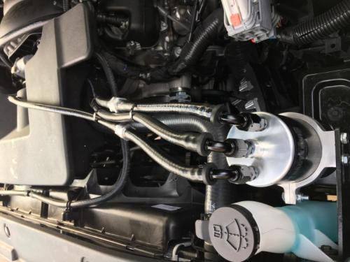

Installed a Dual Valve catch can with CSS on my new All Terrain 6.2 at 130 miles .......naturally intake behind TB was clean, have had catch cans on last 2 LS motor trucks Im a believer 1 st time for a dual valve I tow alot post-169942-0-87894600-1493162279_thumb.jpg
Question does anyone know if a decal is available that looks the stock oil fill cap eg. Dexos 0-20 etc be nice to make the CCS breather look more factory
I installed with the stock airbox for now have an AFE to install but gonna leave the stock intake on for a about a month or so to get a baseline on how it runs
Have had the GM performance Exhaust 23462043 installed for last few days I really like it almost stock sound in cab and nice deep roar under acceleration but still quiet enough to converse
I've got to ask...what made you go with the Tracy Lewis can over Elite Engineering, etc.?
Same can just labeled different plus I was buying a bunch of stuff from Jegs and got free frt
