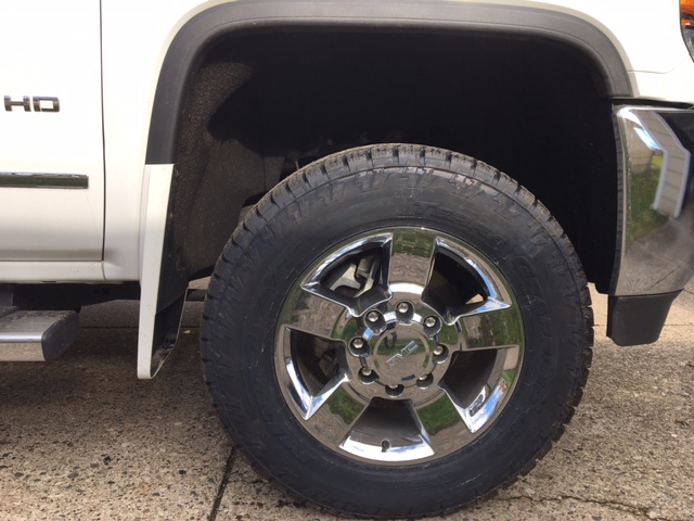

Is anyone running a 295/70/18 tire with leveling kit on a 2016 2500 HD? Is there any rubbing at all or is it even close? I want to go with this tire but I don't want to trim or have any rubbing. Also, please post some pics if you have them!
Thanks!
Cranked torsion bars, stock keys, air bags rear, 35/12.20-18 on stock wheels, no rubbing 36784492f0aa06e91bd9929ee980a3f3.jpg3ab910107f6099edddce0abefd54beeb.jpge469ae24c0ddc638f93358dc1629f2d0.jpg

These are 285 65 20s and are very close in size. Also a 2in leveling kit. Not even close even at full crank.
