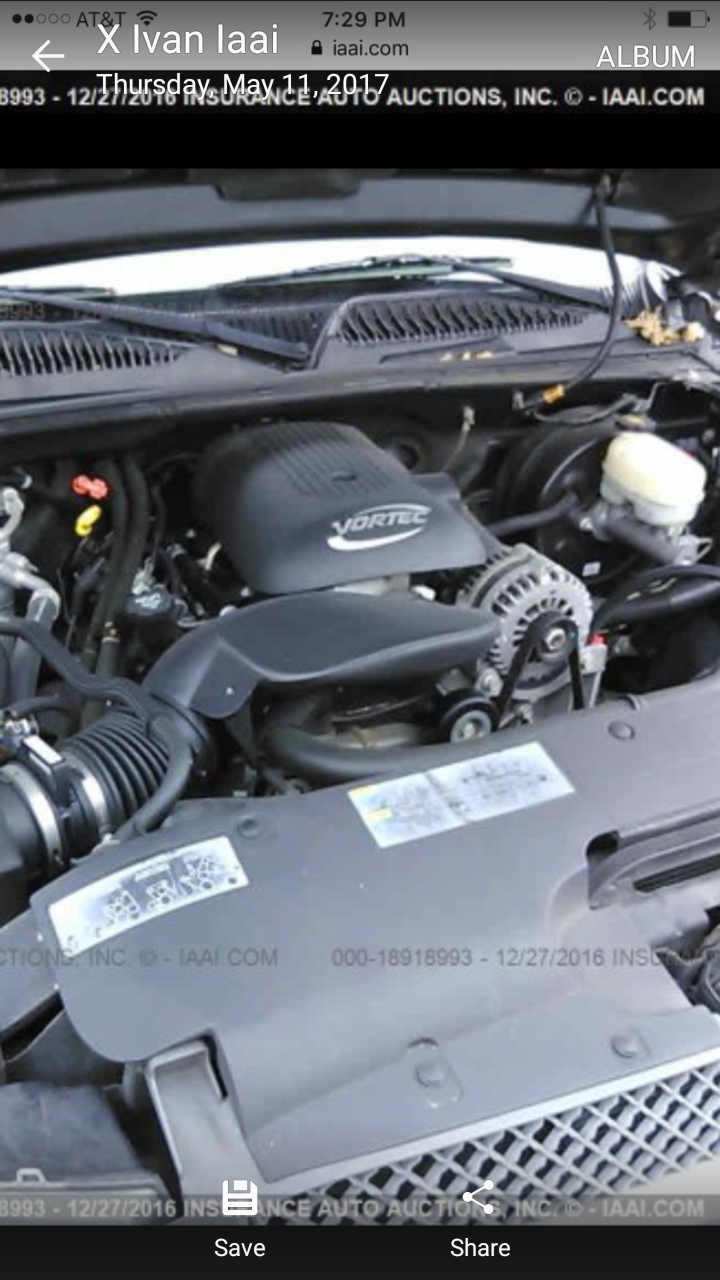

Do not get a 4.8 unless you plan of forced induction with it. 5.3 at least or preferrably a 6.0
Sent from my SM-G925V using Tapatalk
You can't tell from the pic. If the Vin has V it is 4.8, T or Z is a 5.3, N and U are 6.0
