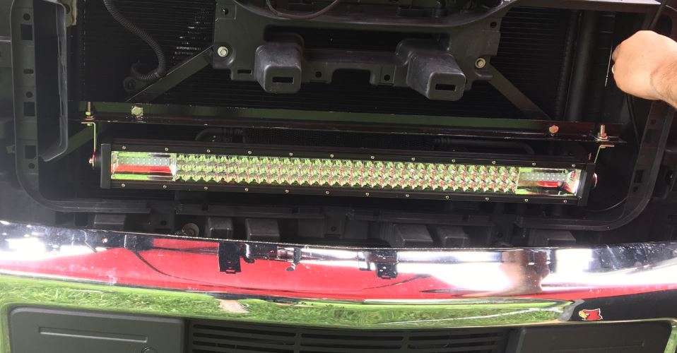

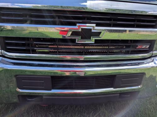

I used a piece of angle iron, and made my own bracket to hang down from the cross bars. Use a piece of steel behind the cross bar when drilling, it's $700+ to replace an air conditioning condenser. I used some steel spacers to put the angle iron out away from the cross braces, approximately one inch out. This gave me the exact room I needed for the depth of the light to sit directly behind the grill. Works well.
I also have a Totron wireless controller for the LED bar, which allows me to control it from the cab without having to run the switch. The manual switch is under the hood, and the controller works from outside or anywhere.

that looks great. What size light bar did you use?
