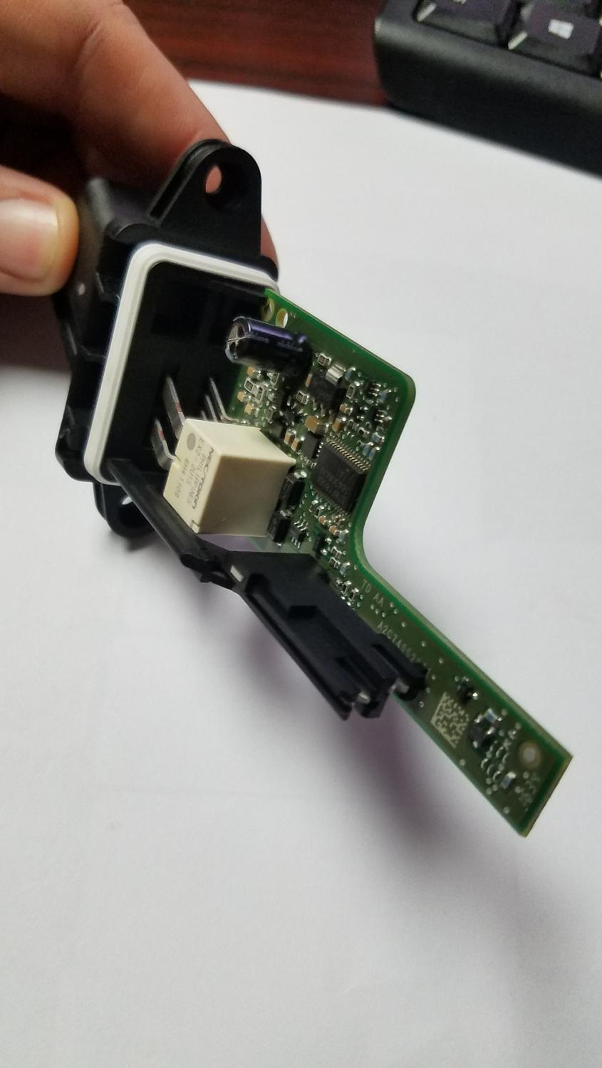

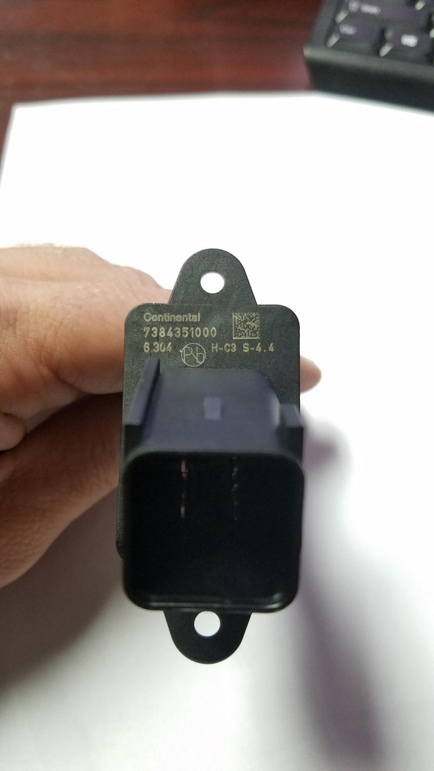

A little background for you. I own a business that receives truckloads of misplaced or damaged freight. Occasionally we get items that we cant identify and that's when come to the experts (you guys :fingersx: ) for help. This part is a replacement part made by Continental and but the markings on the box we believe it fits a GM product but that's about as far as we have gotten. Any help would be greatly appreciated. If you all enjoy this I have a slew of other things I can't identify lol!
I added 3 more to the original post
Nice just noticed them. Almost seems like a blower motor control module, however its got a weather seal instead of just a foam seal. Looks like it mounts into something based on the two bolt hole base all around it.
This is that white box that's on the circuit board: http://www.mouser.com/ProductDetail/KEMET-NEC-Tokin/EX2-2U1S/?qs=rjnFDYRVT0o1PTUlYWPTNg%3D%3D
http://www.mouser.com/ds/2/212/EX1_%20EX2%20relay%202012-820478.pdf
DESCRIPTION
The new NEC EX2/EX1 series is PC-board mount type and the most suitable for various motor and heater
controls in the automobiles which require high quality and high performance.
The EX2 series is succeeding in about 60% of miniaturization in comparison with the ET2 series. The EX1 series
is succeeding in about 50% of miniaturization in comparison with the ET1 series.
The description of that little box seems to support my blower motor control theory...now to ID the rest LOL.
