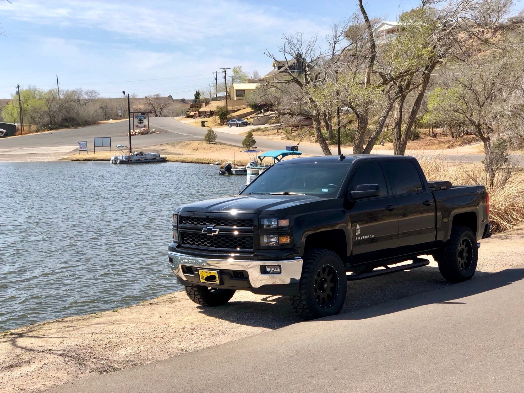

boynton6spd
295-55-20 Fuel Nutz 20x10 -12, Nitto Ridge Grappler , Levelling kit
Great looking truck. 2” level? Rear blocks? I love this look. Running? Can I just have your truck? Lol
