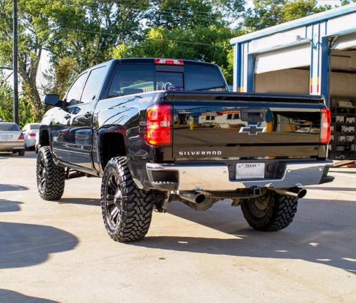

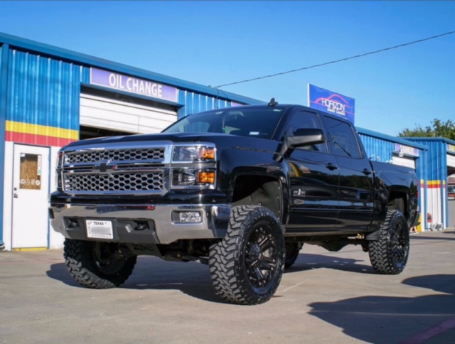

20×10 -12 offset with 35×12.5 .. they stick out about 2 inches from top of fender93c2a534632218ff65eaeacef91be959.jpg5ebf53f104a8e0d4e8fefe981c17ce32.jpg
35x12.5 Toyo Open Country MT
Rims are Monster XD 20" +18 offset.
With the 35's the back tires barely clear the fender. Due to the zone lift, the front tires are about 1.5" past the fender.
why does that lift make the fronts stick out more than the rears? the lca's?
The new knuckle that comes with the kit pushes them out. I have OCD, and it bothers my if I stand behind my truck. Not enough yet to do anything about it. I was going to add hub centric spacers to the rear, but not sure I want to go that route.
