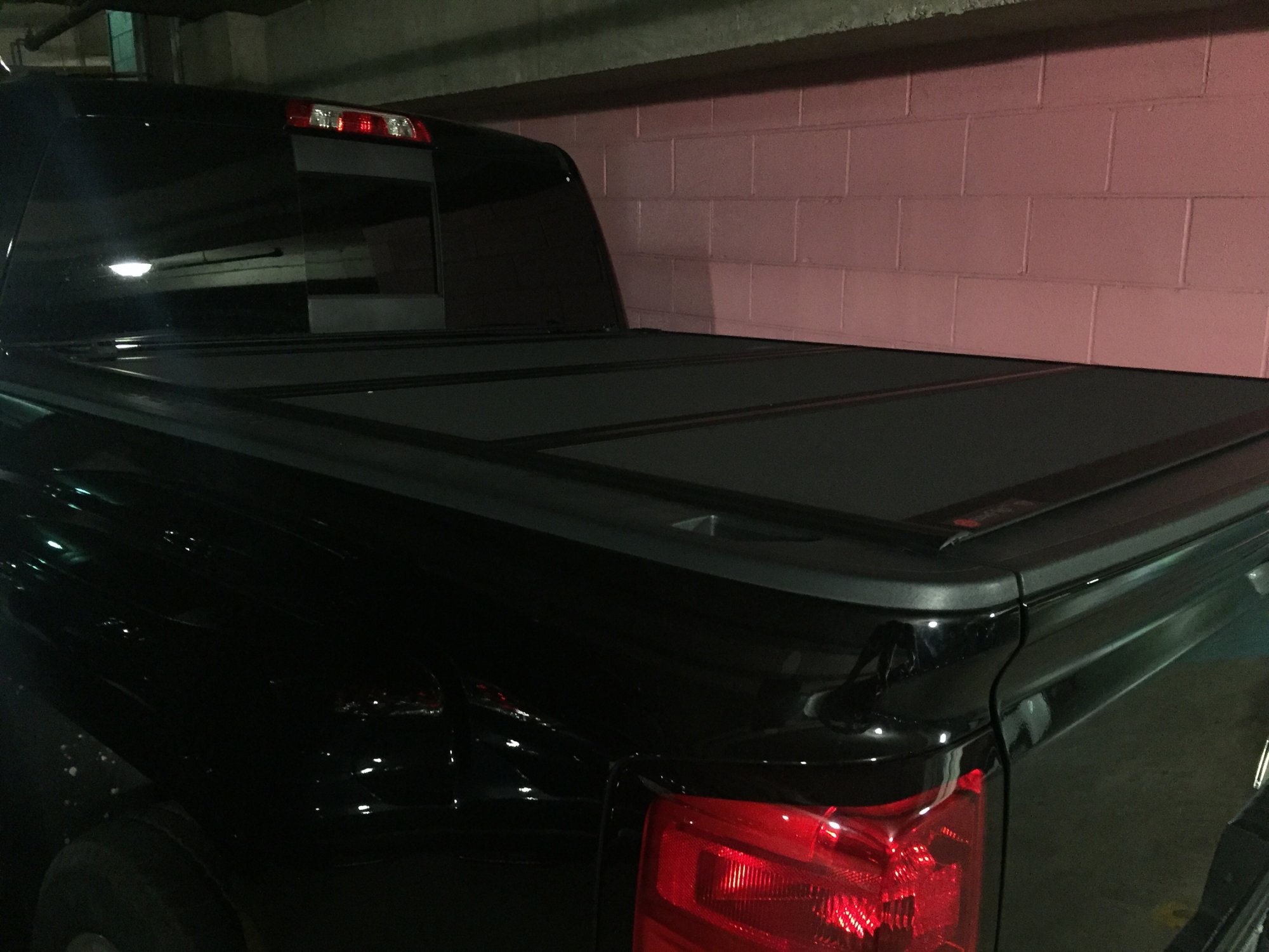

I installed a 46inch black toolbox from tractor supply under the Bakflip MX4.  I am very happy with this combination.  I like the ability to lock the toolbox independently of the bed cover.  There are only a couple of downsides to combining a bed cover with an in the bed toolbox.  This is what I ran in to:
1.  In order to open the toolbox completely, it has to be positioned away from the bulkhead slightly because the bed cover gets in the way of the opened toolbox lid.  I used a 4x4 block as a spacer and this worked perfectly.  In effect, I lost 4 inches of bed space by doing it this way.  I use that space between the toolbox and the bed to keep things that are too long to fit in the toolbox, so its not a huge deal to me.
2.  I tried fitting the 60 inch toolbox first, but this just didn't fit.  The Bakflip prop rod hardware gets in the way of the toolbox.  There might be a way to rig up the prop rods differently or just remove them altogether.  I didn't mess with it and just downsized to the 46 inch toolbox.

This is a very clean setup. Do you find yourself needing the truck bed space, though?

very clean look......
For my purposes, I haven't found myself missing the bed space.  There is still room on either side of the tool box for really long items to slide in.
