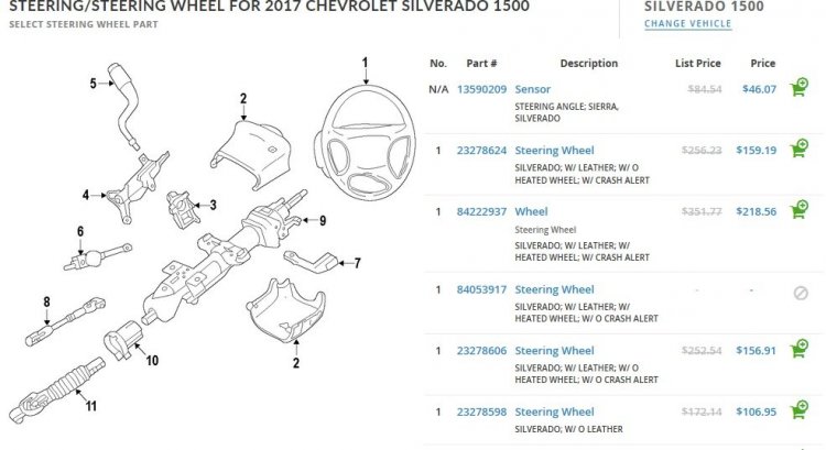

I'm looking to upgrade to a heated steering wheel. I found a used one but I can't seem to find out for sure if it fits...
From the part# - 23278656 , it seems to be from a 2500/3500 and has the collision alert button as well as the heat option.  Most of the parts sites just list it as discontinued but don't list the fitment.
Can anyone tell me if this wheel would fit on a '17 1500?
Thanks for the help :thumbs:
One of the sites I used says that it was replaced by 84053954, which was replaced again by 84222943
Unfortunately, neither of those numbers crosses for a '17 1500.
