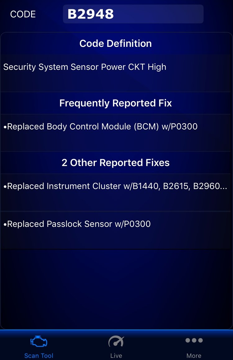

So I got the Lemur BlueDriver scanner. This is what it shows for the B code. Pretty cool device actually.

Well, after pulling hair out, I broke down and called the dealership. My neighbor is good friends with the General Manager and he was able to help me out. They reset the Passlock system and found a lose wire that was associated with the Passlock system *shrug*. So long story short, truck has come home and runs better than it has in a while.
