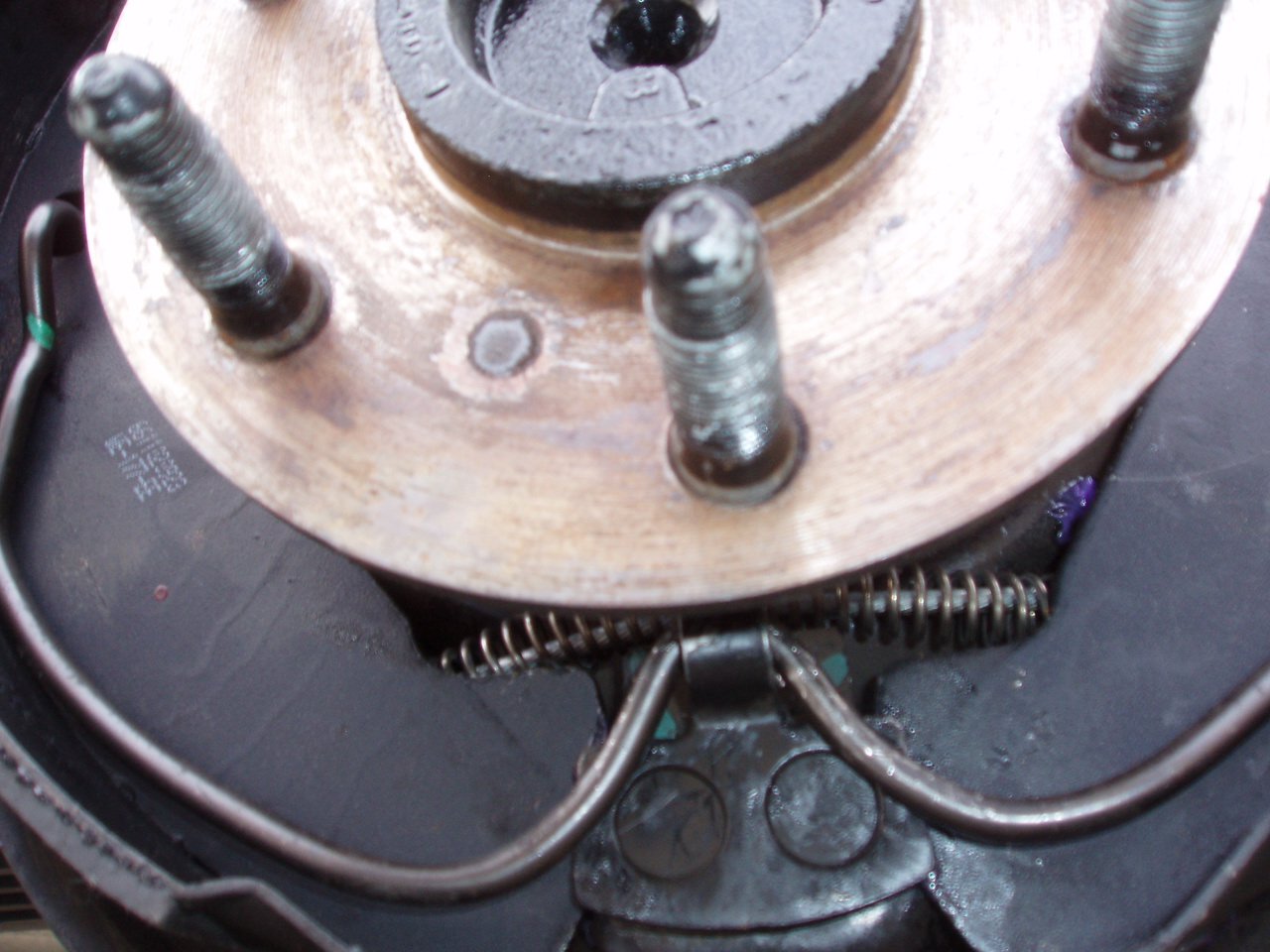

Now, big difference between 2007 rear drum brakes, and 1972 drum brakes - need to know model and more importantly, the model year.

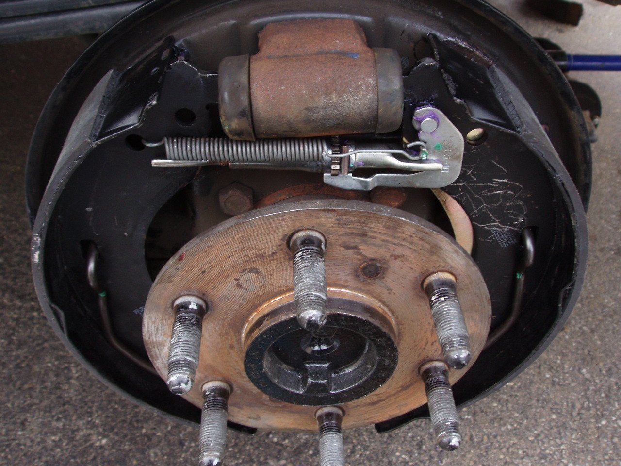

Here's a pic of my '07 Silverado 1500 rear brake spring - there's only one (a BIG one), if you don't count the spring on the parking brake cable, and the adjuster spring.  Older vehicles have  at least 5 springs.
My '07:

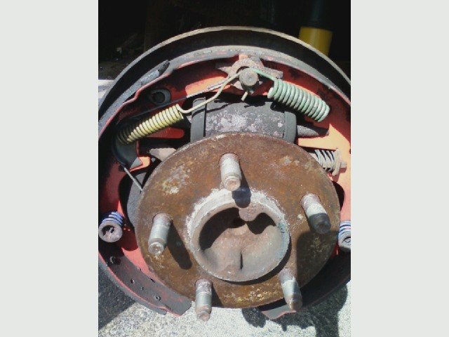

My '86 Grand Marquis:
