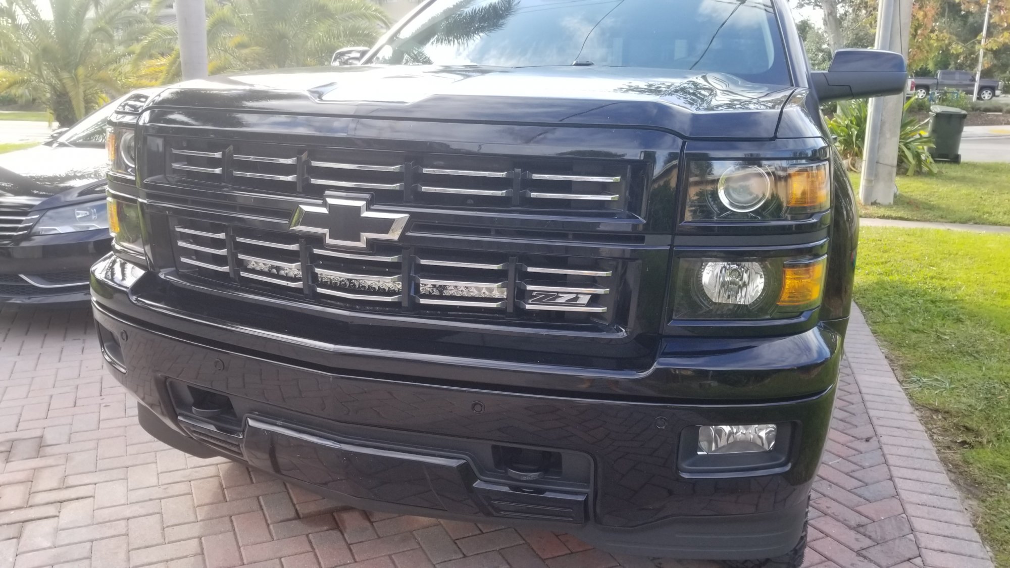

Nice truck. How's the radio reception with the antenna relocation?
Sent from my SM-G955U using Tapatalk
No issues yet. The primary 2 FM stations I listen to are fine. We do listen to mostly satellite so I can't say quantitatively before and after.

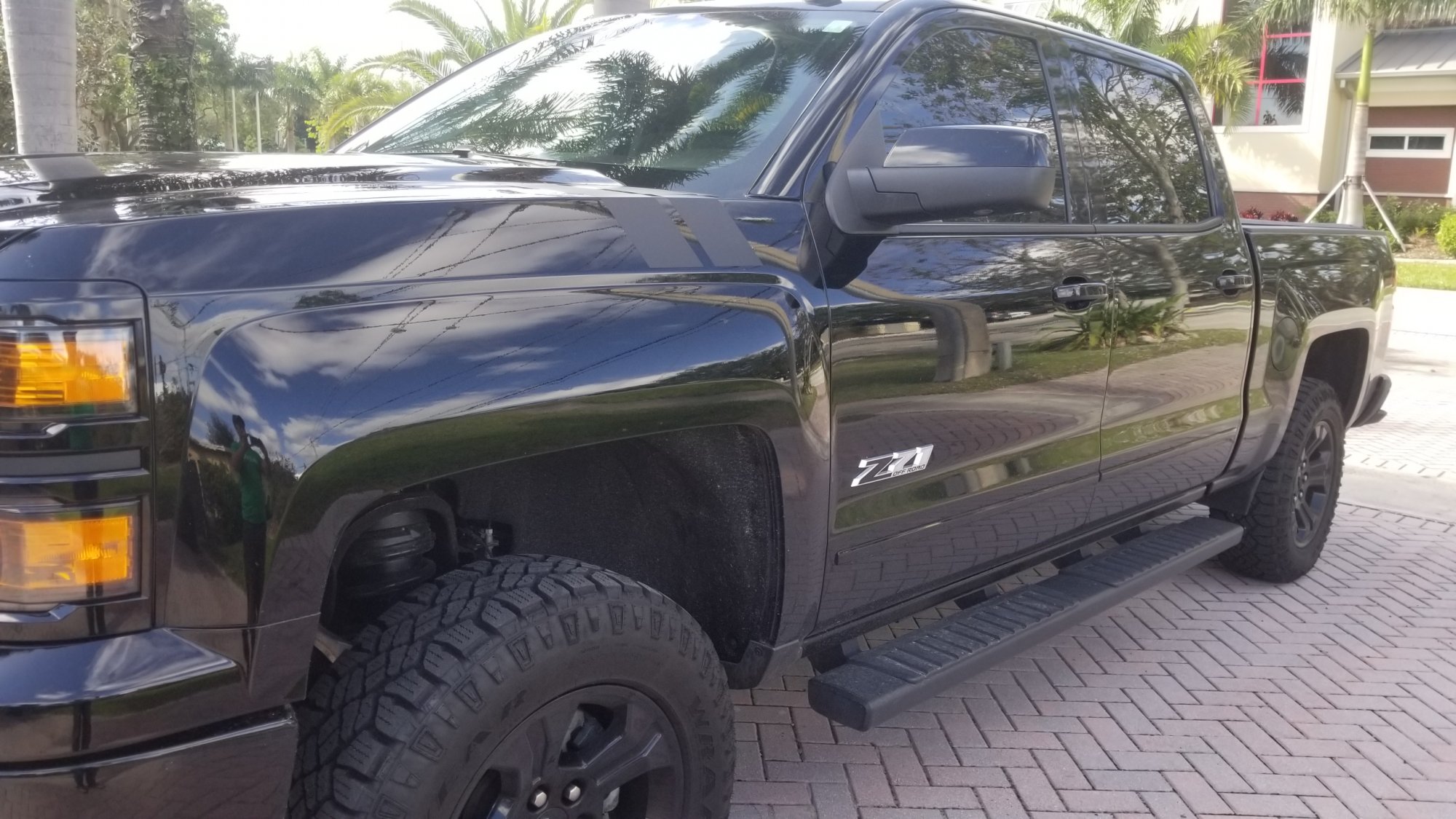

I couldn't wait. Blessed with a gorgeous sunny, 65 degree south Florida day, so I figured I'd tackle the front. I was going to bite the bullet and pay to have it done, since I have to have it aligned anyway, but it's not in my nature to pay someone else to wrench on my vehicle if avoidable. Took me 3 hours by myself and wasn't too difficult. Hardest part was breaking the ball joint loose, then getting it back together (the entire ball joint spins with the nut once it's free. I'll take it tomorrow and have it aligned. Hopefully, it'll settle in the front a bit as it's about 1" higher than the rear right now (sitting at about 39" in the rear and 40" in the front to the fender well).

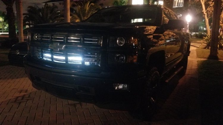

- added a 32" curved be LED bar behind the grill including a wireless on/off controller that I programmed into the homelink buttons. Pretty simple mount actually. Was able to use the regular included brackets and drill holes in the rigid plastic bottom panel for the bolts.

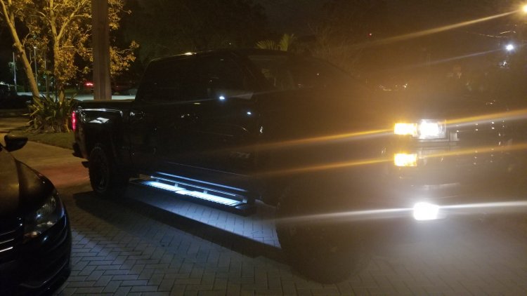

- added my LED step lights wired into the dome light circuit tapped into the wiring block. I put a dimmer inline to control the brightness. I'll tinker with it but overall very pleased.

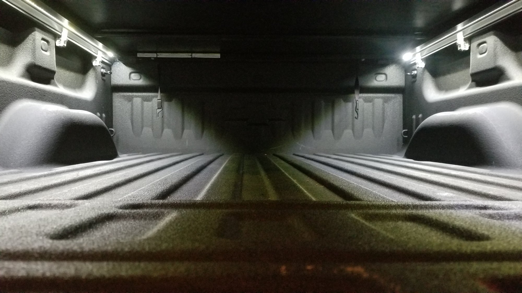

I also made time to add the bed LEDs (under rail). I tied them into the same dome light circuit as the running board LEDs.

Finally got new shoes on the truck. Tucked in 295/70/18 Nitto Ridge Grappplers with plenty of clearance. These are almost 3" taller and 1.25" wider. Love it. I'll get better photos once it washed up.
