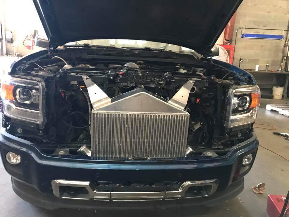

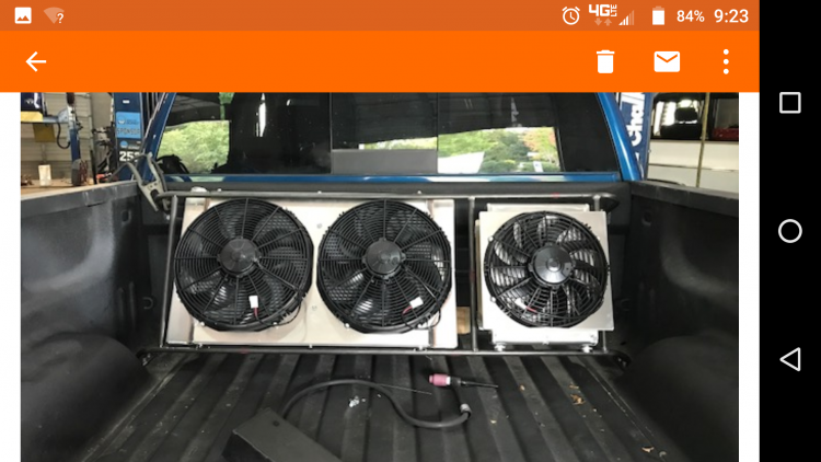

416 ci,Holley hi rise 30% over injectors,3 wallbro 450 twin 82 mm turbos meth,big ass custom intercooler, radiator and trans cooler bed mounted 5 inch carbon fiber drive shaft,6 piston 17 inch rotors HRE rims 315 Michelin PS4.ran out of high pressure fuel waiting till March to make it to 1000 rwhp,when higher flow pump is available. Yes Corvettes and cameros are making a1000 rwhp, but they are not running thru a trans case or a 9.76 axle
