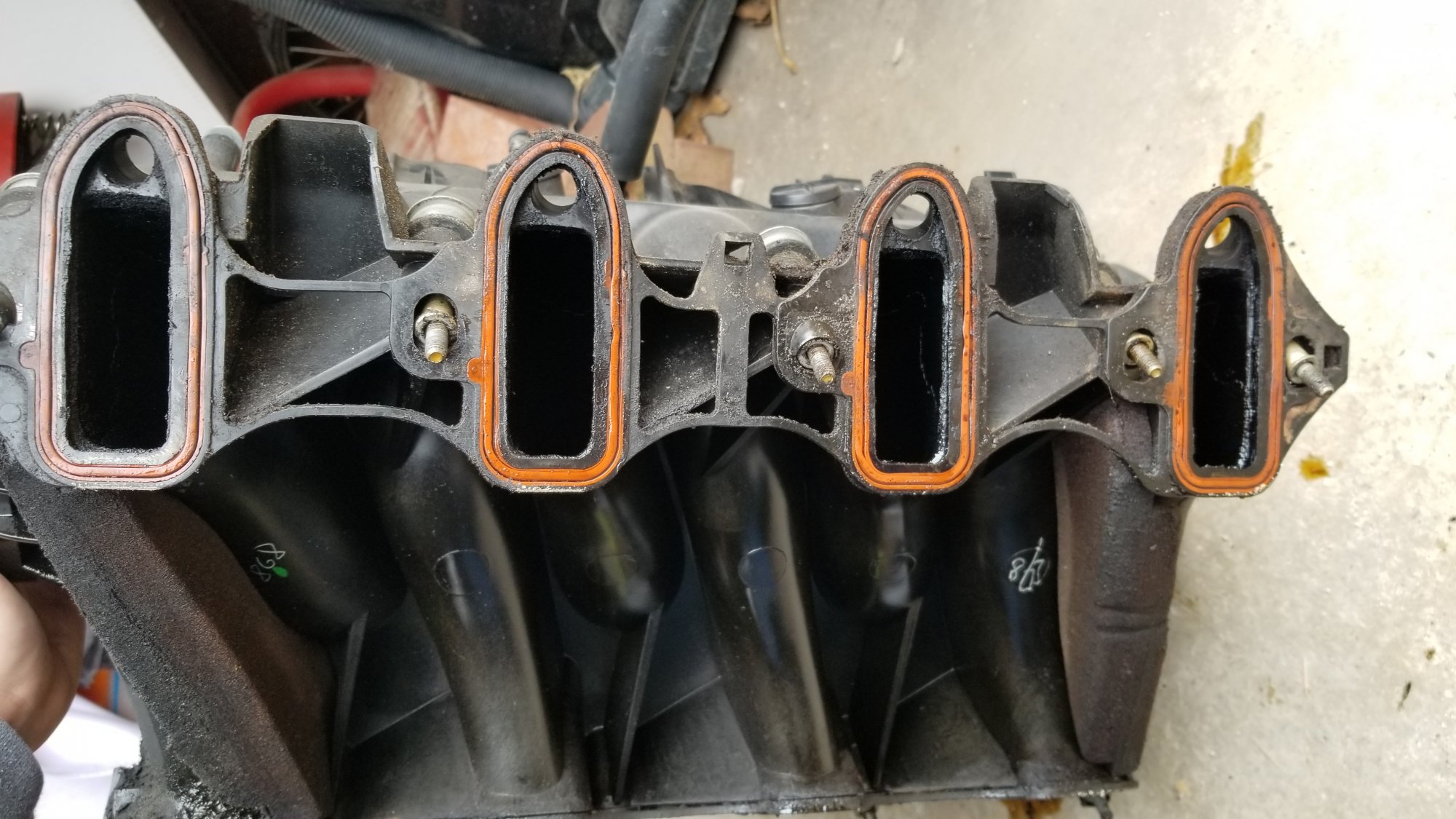

Ok, i got the gaskets on yesterday and drove the truck on the street and it seemed like it was fixed, the engine light turned off and no irratic misfire. In the process or replacing the gaskets, i took the manifold off and when i tipped it on its side about a cup of fresh oil came out. Im not sure if it came from the pcv or just because the gaskets were leaking so bad. I cleaned both surfaces well and the hardest part of the job was taking out and installing ths manifold /popping in the injectors. It was very easy to pop in the left side injectors but the right side just did not want to go in be eventually they went in. I will post before and after pics at the bottom. Im sure you can spot where the gasket was failing. Also, a big thanks everyone in the process of getting this thing fixed.
i hope the problem is gone for good, glad you got it sorted out! i know it can be insanely aggravating, but you were patient and stuck with it. and now you know how to diagnose things instead of just throwing parts on left and right haha
Me too, yes it was very aggervating and in a way if was worth it because like you said, i know how to diagnose things better. Now just gotta put a leveling kit on her soon. I put up a thread for that also because i cant seem to find out what height i need. Thanks a ton tho!!
