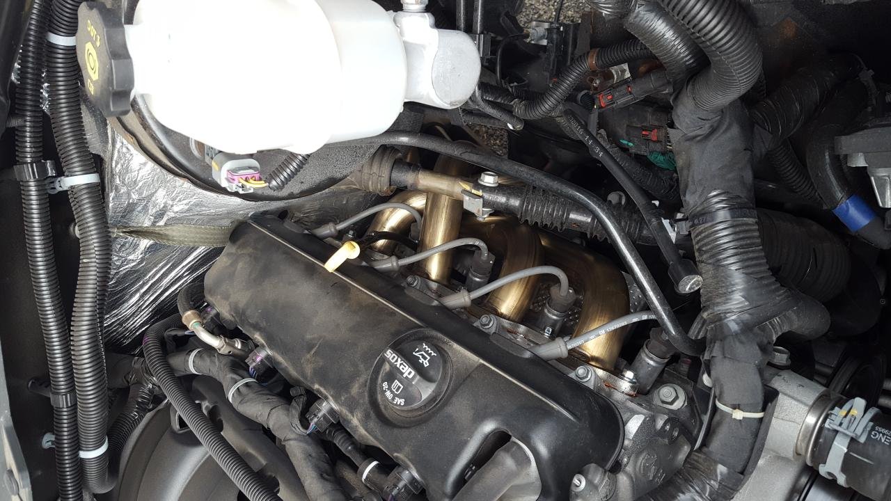

OK so I pulled the trigger after talking to American Racing and BB tuning and got a set of the catted 1 7/8" long tubes for my truck.  Got them installed leaving the factory Borla touring exhaust.  So a few issues, I did the data record for Justin and got a retune back but am still throwing the cat codes P420 P430  Catalyst system efficiency below threshold.    These are the catted pipes just deleting the 3rd cat.
What are others going to get rid of these codes?  Both AR and BBT said there will be no codes or CEL.  Secondary issue is the remote start is inop with any CEL.
My other concern is the exhaust is very raspy with the Borla muffler.  Really bad under a load and shifting.  What mufflers are your guys using while retaining a lower sound. Now I am pretty tame normal driving and sounds about as loud as I want under load and higher RPM, just not the tone Ive been used to from my old truck.  I don't know of its the muffler but the headers really made it pronounced.

What tuning software are you using? I had the same issue when I put my Kooks on. My truck went pig rich. My tuner was able to address the issue no problem. If you have HPTuners I know you can set it not to set the engine light but continue to monitor.

Those codes can easily be disabled from triggering a CEL. I have HPTuners and that is about the only thing I know how to with it besides flash a file.
