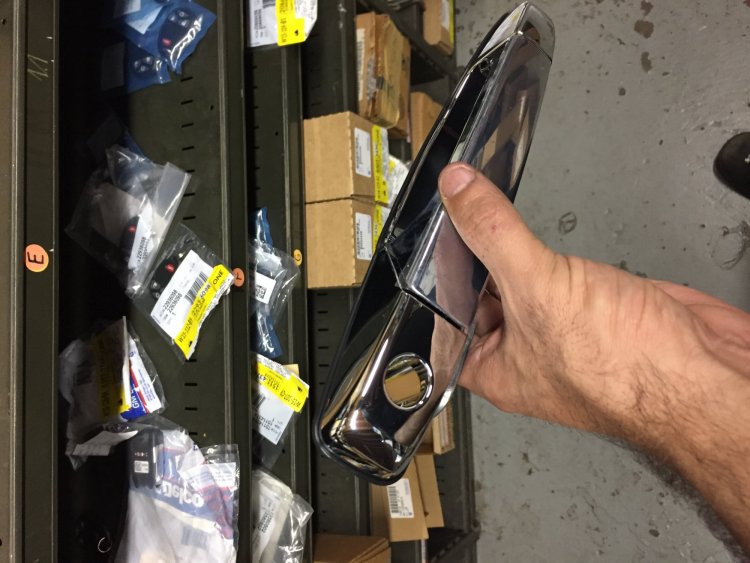

Ok so this is a replacement handle off a 2012 sierra. The black part is what we are talking about?

No, the large gasket that seals the entire handle against the door is not the one I am talking about (can't take a photo of my truck handle right now as I am not near my truck at the moment).
Presumably the handle you are showing is the same as mine in this respect - if you pull open the handle, there is a small (about an inch by an inch) gasket that surrounds the "post" (not sure how to better describe this part but it moves in and out of the hole in the rest of the apparatus when you pull on the handle) at one end (the end that is not hinged) of the handle. The gasket can not be seen unless the handle is pulled away from the rest of the handle apparatus, as when opening the door.
Actually, in your second photo of the rear of the apparatus, adjacent to you first finger, it looks like that black squarish thing is the "post" I am talking about. If you turn it over and pull on the handle, this "post" pulls part way out of the hole and encircling the post is the gasket. The gasket is not secured to anything and is only held in place by the post, and it actually moves a bit when pulling the handle. I presume the gasket prevents water from entering the hole and is held in place by pressure when the handle is closed.
Marv
Ok I understand exactly what you're talking about. I will look at it again tonight and see how hard it is to remove the actual handle part itself. I will take pictures.
