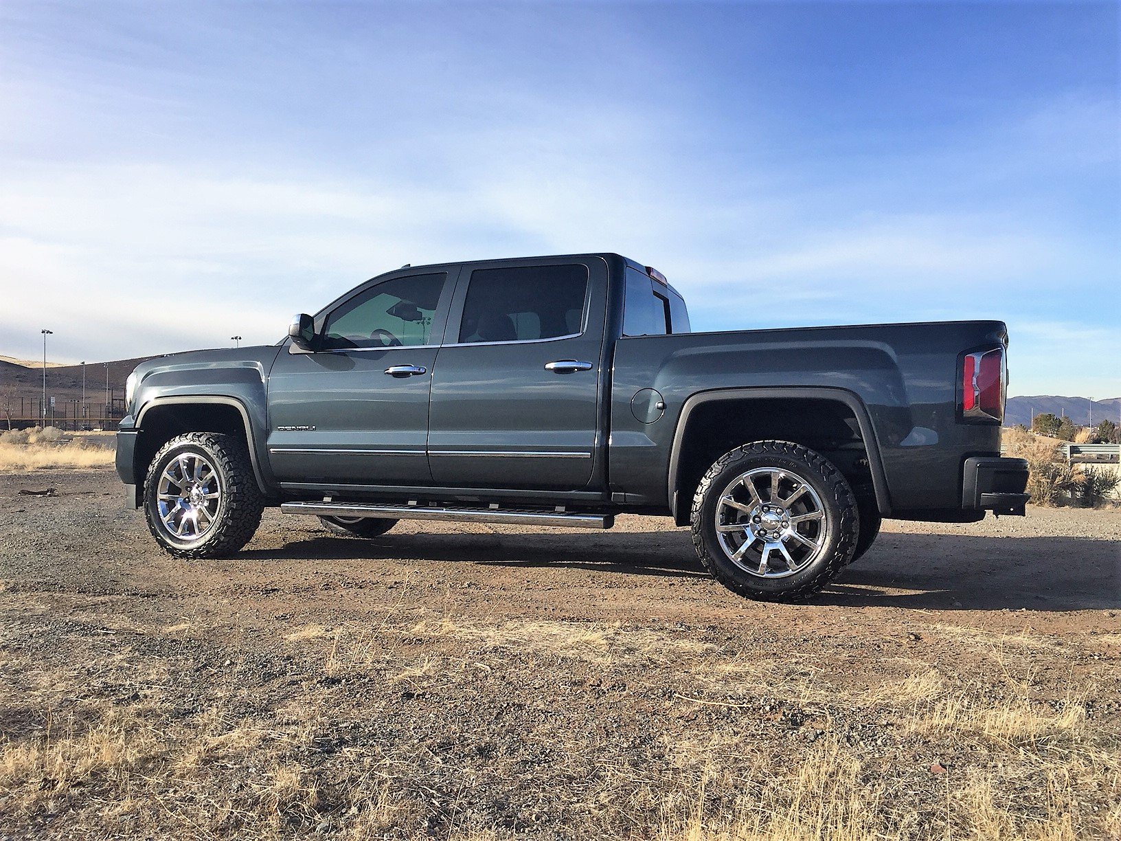

I have a 2017 denali pickup 4 wheel drive. I have trouble anytime i am in ruts that are just slightly deep with front spoiler rubbing . I am afraid i am going to knock it off.
My question is what problem would i encounter by putting a front end lift to level truck and give more ground clearance?
What would be the largest size tires on 20 inch rims   could run without rubbing issues .

you can run 34.5 tires with 1.5-2" lift, I'm guessing.
20170407_123901
I went with a 2" level kit and 285/55r20 BFG KO2 tires.  Not much bigger in tire size, but did improve the ground clearance at the front valance nicely.  No longer scrape it on parking blocks & even kept it off rocks this last weekend while on a mild offroad trail run.
