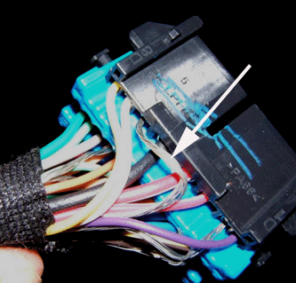

The radio low level signal drain wires may be too long.
Check the bare wire at this connector and see if it is touching other terminals.
if it is just pull it back and take the excess with electrical tape.
It is located under the floor console cup holders.
Fixed so many of these I have lost count.

Ok this wouldn't apply to your vehicle then. Check the wires going into the back of the radio. That is where your problem is more than likely terminal 11 at the back of the radio.
