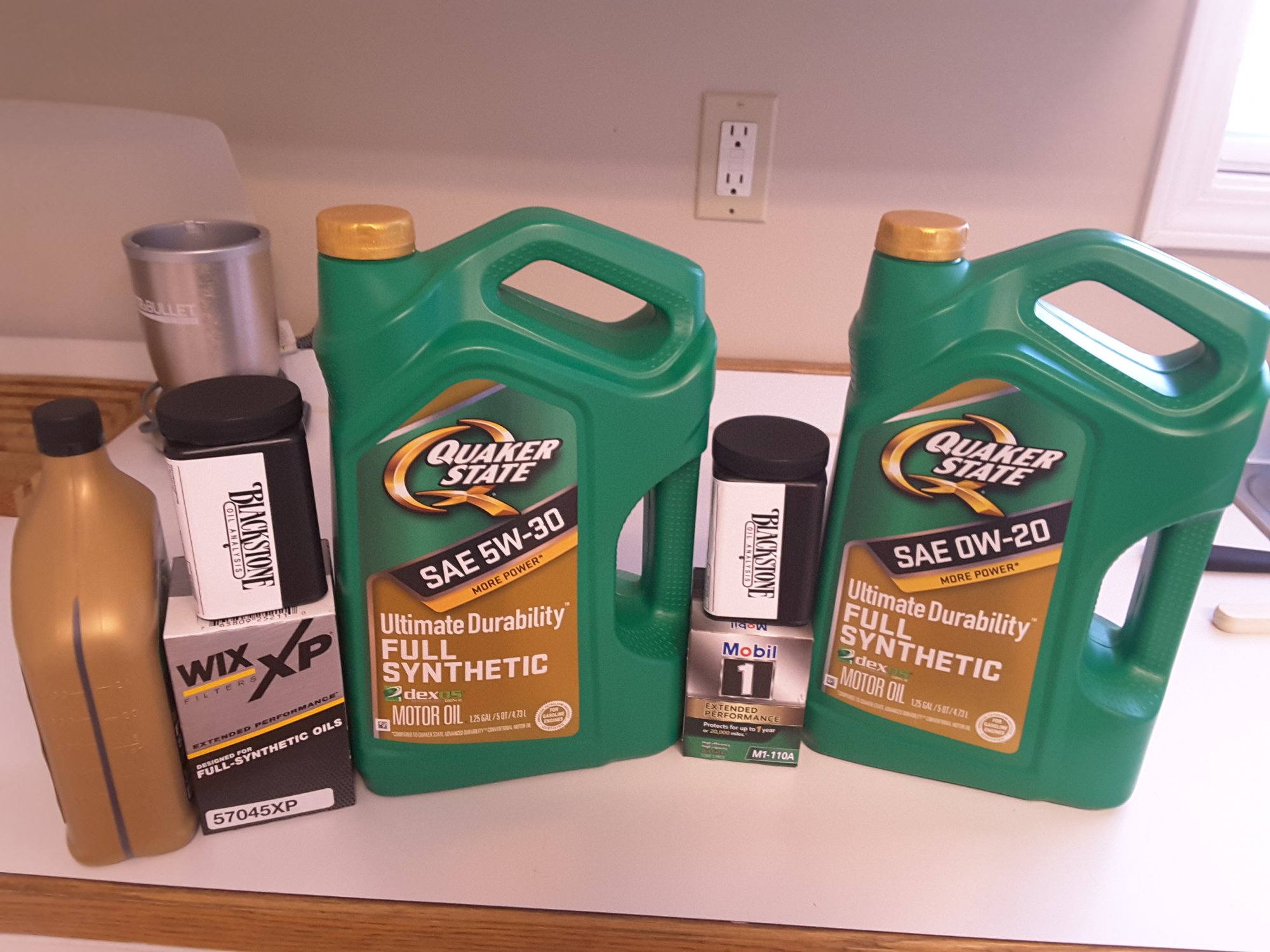

Running the 17th ranked oil in the 6.0 and running the 6th ranked oil in my girls car. Quaker State Ultimate Duribility (Gold label and/or Gold cap) has a soild additive package and exceptional Anti-wear performance for the price. 1 gallon jugs for about $20 at Wal-Mart.
