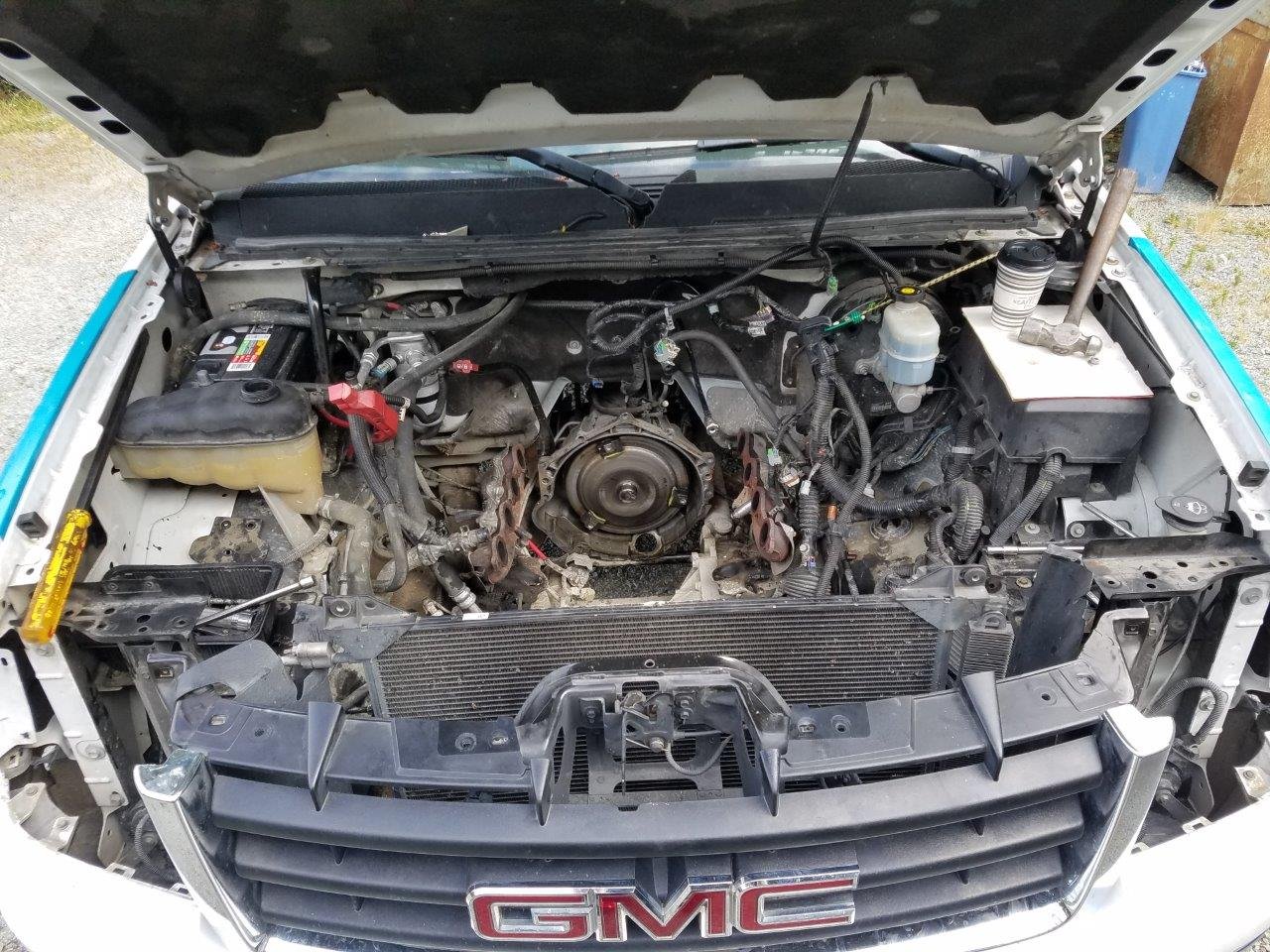

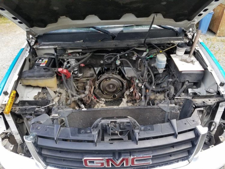

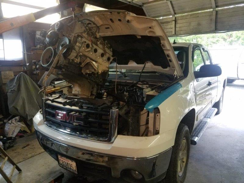

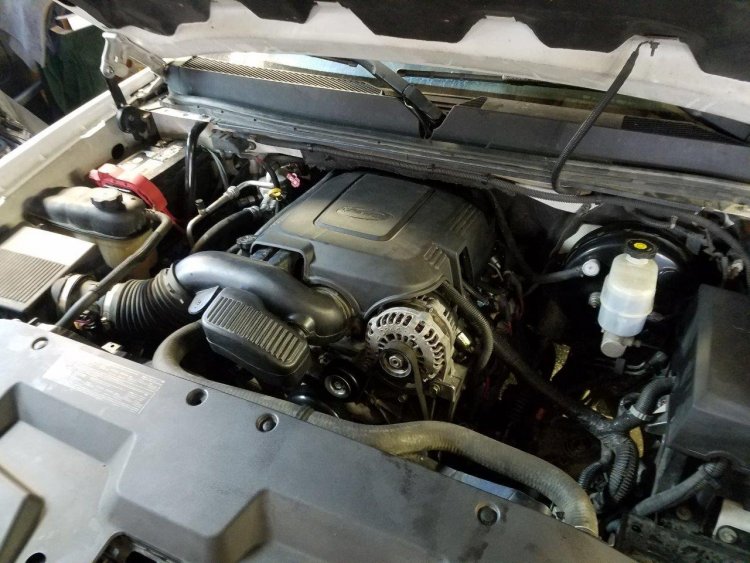

I just did a motor swap on that same rig. I bought a used motor online.
The compression tested good before they shipped it to me.
I verified the compression was good prior to installation.
84K miles were on the replacement motor
Shipped from the other side of the country
90 day warranty on the motor
The total cost out the door was $1300, with no core charge.
The motor runs perfect.
Personally, I would recommend doing the same thing that I did and get a used one.
