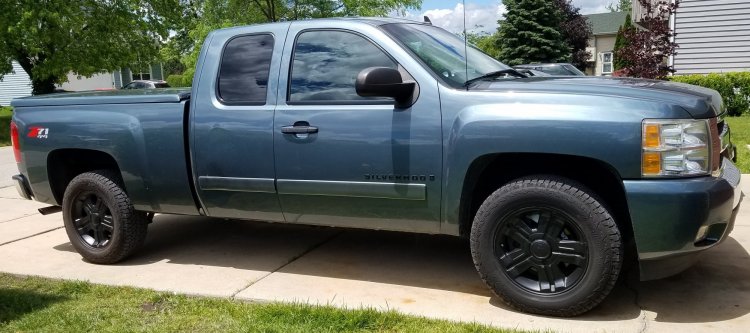

I want to buy the 2 inch level kit from Rough Country. Been watching a lot of YouTube videos of different ways to install it. What do y'all think is the best and easiest way to install it? If you could send a video link or instructions it would be great. A local shop that does lifts sells tires rims the whole thing said it would be $500 to install. I think that's crazy the part cost $50 and $100 for an alignment at most. So any help would be appreciated thanks let me know guys.
the easiest is to install a bottom spacer. jack the truck up by the frame , take the wheel off. unbolt sway bar, take the two bottom bolts out of strut. now you can push the hub down and slide the spacer in. reinstall all the bolts and your done.
i did the 2.5 on my 07 nbs in prob under 1.5 hours (air tools) and a few beers. most of the time it was looking for the right socket i just had in my hand. rear the tires stayed on to put in the blocks. the instructions show using a wrench thru the wheel well to get the upper strut nuts off, i found it easier and quicker to impact them off from up top with extension.
Follow the instructions that came with the kit. When I put the leveling kit on my truck I didn't read the instructions for the first side and I fought with it for about 90mins. after I finally decided to look at the instructions I did the passenger side in about 10 mins.
