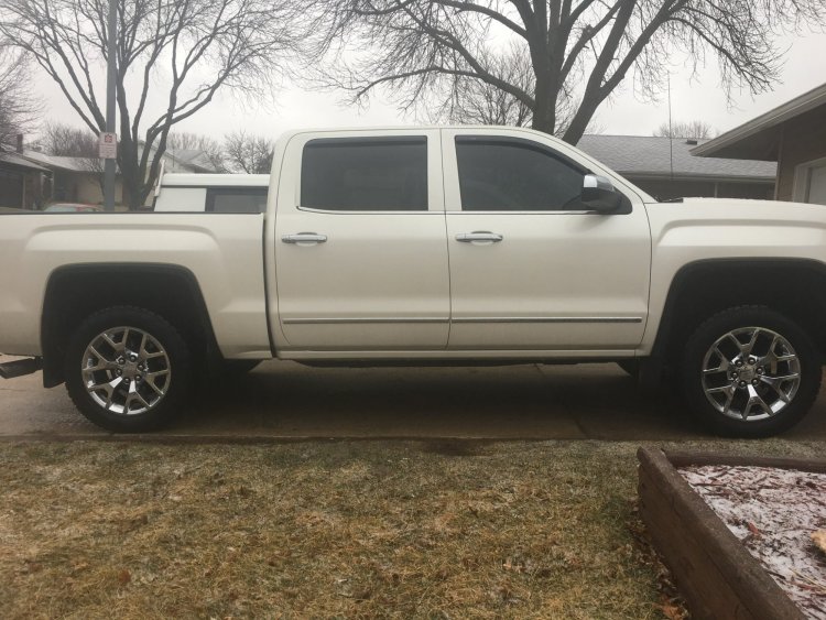

Forgive me if this is long but i want to be as detailed as possible. I bought my 2015 gmc sierra all terrain used. I noticed when i bought it, the rear blocks were removed. I assumed the person before me wanted to level it so i didnt think anything about it because i planned on getting the rough country level/lift kit for it. So after installing the RC level/lift i noticed i now had reverse rake, and quite a bit (ill post a pic). The lower control arms on my truck are aluminum and i noticed the uppers are steel. Upon further research, it turns out that the upper control arms are actually rough country UC. So Anyway, to fix the reverse rake i put 3” blocks in the back, and that helped quite a bit but there is still a bit of reverse rake, and if i so much as put a sand bag in the back, it drops quite a bit. Now i understand on a leveled truck your going to have reverse rake when hauling, but i feel like its squatting too much. So one of my questions is, are the rough country control arms pushing the front of the truck up higher?? Ive never heard of someone having to put 3” blocks with the RC kit to level it out. Its quite obvious there was a lift on the truck before i bought it (which explains the blocks missing and the upper control arms). My thoughts on an easy fix would be a helper spring. I was thinking hellwig springs because there is a bit of adjustment on those (if i understand them correctly) im not too terribly concerned about ride quality, but maybe some of you folks would have some tips, tricks, advice etc... to help me out here. Amything would be appreciated. Thanks!!!
P.S. the second pic is without the 3” blocks.

What size rc level is it?
I went with the 2.5" level/lift kit from rough country, 2.5" in the front, and 2" blocks in the back, but i ended up putting the 3" blocks ( theoretically its only supposed to bring the back up another inch, but since i didn't  have the factory blocks, it all worked out) which are supposed to replace the facoty 1" blocks. Just sucks that it had so much reverse rake that it looked goofy. I thought for sure the 3: blcoks would make it perfect
The stock block is 1.25. So you have to take into account deleting that when you put the new block in
That shouldn’t make a difference tho right? Since the RC lift comes with a 2” block and your supposed to remove the stock one anyway. I have 3” total block in the back and it’s still sagging a bit. Every other picture of a truck with the RC level/lift looks perfectly level. While mine still has that reverse rake

It might be helpful to post some pictures of the current components installed on the truck. If there is something that would cause the front to sit up higher one of the eagle-eyed members with more experience with lifts/levels might be able to catch it and point it out. Also post the rear set up, there might be something off with it.

If it was my truck I'd look at everything that was done cause usually guys aren't that noise high.  Maybe theres a bigger top strut space in there.  Verify your knuckles are stock etc.
Your truck should have been close to dead level before u level/lifted then?
With the rear blocks removed it sat maybe a half inch lower in the rear. As far as I can tell (and I’m not stupid) everything is stock up front except the upper control arms. Which are from a rough country lift. Shackles in the rear are stock also. It just seems like the front of the truck wants to shoot up and it also feels real springy up front. When I hit a bump or a dip in the road it’s real stiff feeling. Similar to (the only thing I can’t relate to) something like torsion bars on an independent front suspension truck, being tightened (torqued) too much.
Depending on the miles on the truck the rear springs may simply be showing wear so it lost the ride height a bit.  The bed could have been overloaded one too many times.  Not a huge deal just keep an eye on them.  I had a cracked leaf in my 03 once and that side sagged more.  Springy up front possible worn out shocks.
