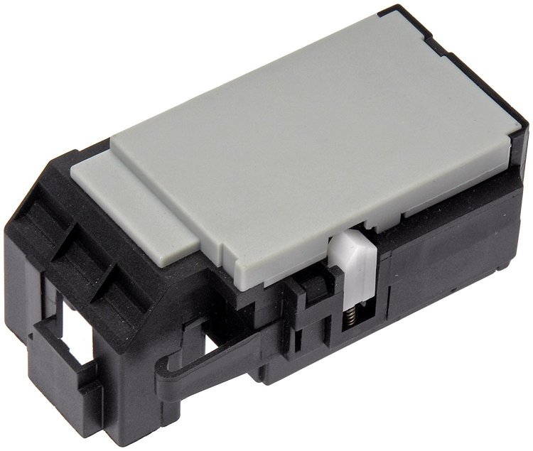

I would definitely look at the ignition switch.The plastic cover surrounding the steering shaft / ignition switch comes off with a few screws on the bottom. Then, one of the large wires is the starter (solenoid) wire. If that wire is not hot while your cranking, then its almost 100% the switch. I suppose its possible that you are not getting power to the switch, but I doubt it. I can get ya the wiring color codes if ya need, let me know.
I just had mine apart, while I was installing a remote starter. If the switch is bad, you could (theoretically) connect a cigarette light power plug to that solenoid wire, and start it that way - but a replacement ignition switch would be a much better option obviously.
If the switch above does not fix the problem try replacing the neutral safety switch. I tried everything else and replacing it fixed mine. 2005 GMC sierra.
