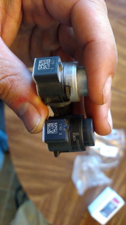

well i finally figured it out
i swapped the inside sensors to the outside and outside to the inside. and now the right sensor is randomly going off.
so i ordered a replacement from advance auto for $30 shipped to my door. $43 regular with 25% off and a $5 coupon.
oem one is like $140 so ill give the aftermarket one a shot.
So the one from advance is identical to oem both are bosch one just has a GM logo and part number.
So no reason to buy the GM one for 4 times the price at advance Auto.
