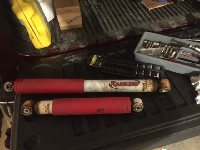

I just replaced the REAR shocks w 4600 bilstein. What a chore....I did this on my garage floor by myself   :(
The Rear Ranchos were SHOT- they would NOT rebound on their own. My truck has 25,000 miles.
Will replace the fronts another day.
