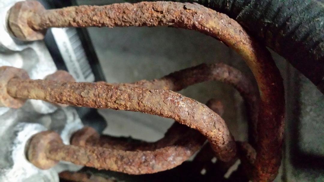

what exactly is holding that truck together?
What frame is that on ? I wouldn't be driving that one down the street.
