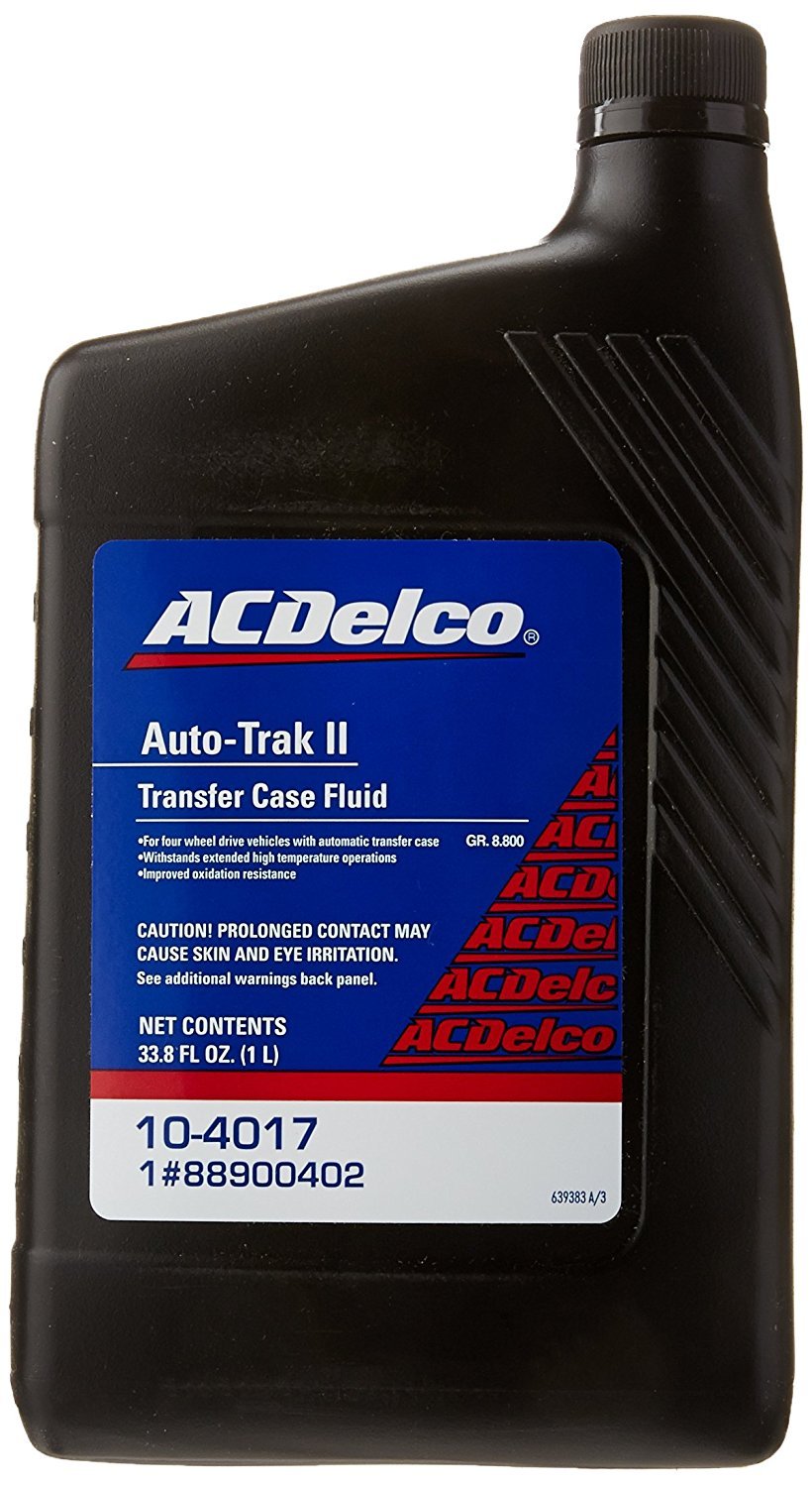

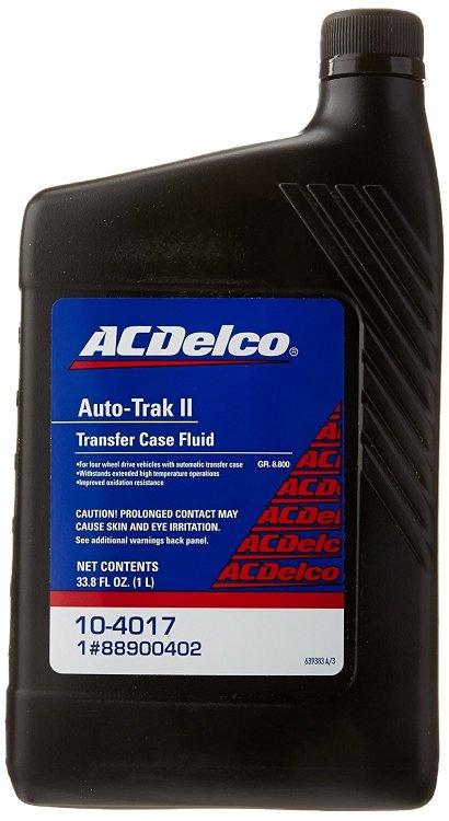

Also, make sure you have the proper fluid. The automatic T-Case requires a very specific fluid.
