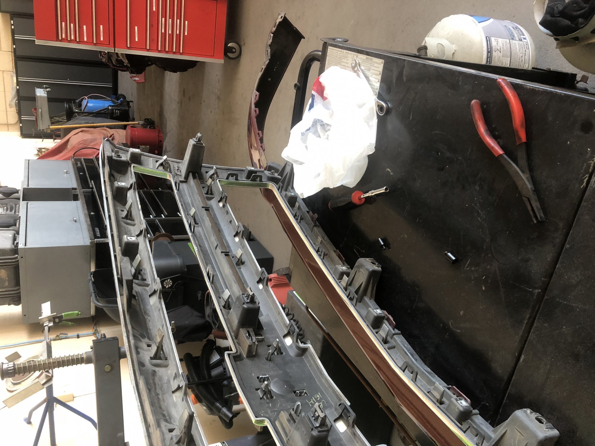

So once you pull the grill/trim off, there’s a sort of cowling you have to remove.  Use the 7mm socket from earlier to knock all these off.  Once that’s complete, you’ll have access to the clips holding your inserts in.
Not sure why image mage is flipped, but these clips are pretty resilient.  I used some wide needle nose to depress the clip and push the grill out.  Be careful and after each clip, slightly push the grill insert off so they don’t pop back.

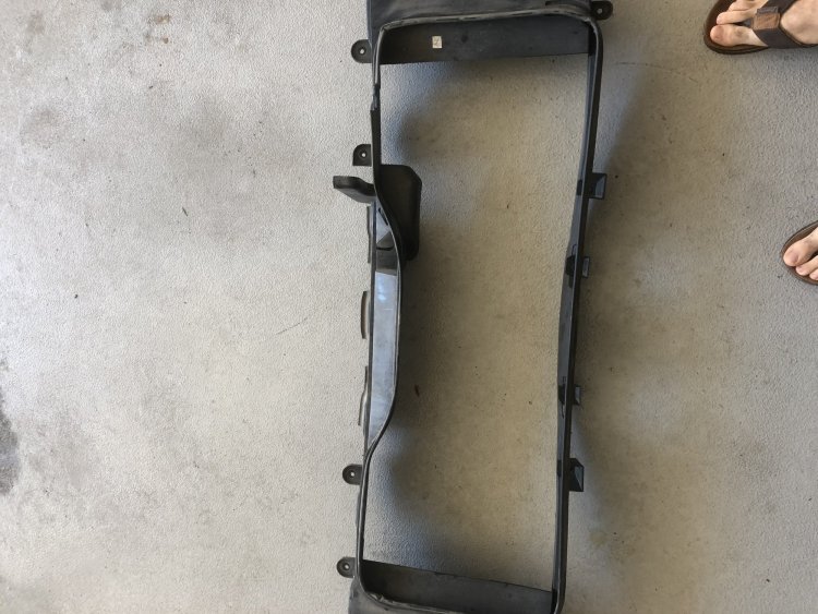

this is the removed cowling you’ll be taking off the grill assembly.

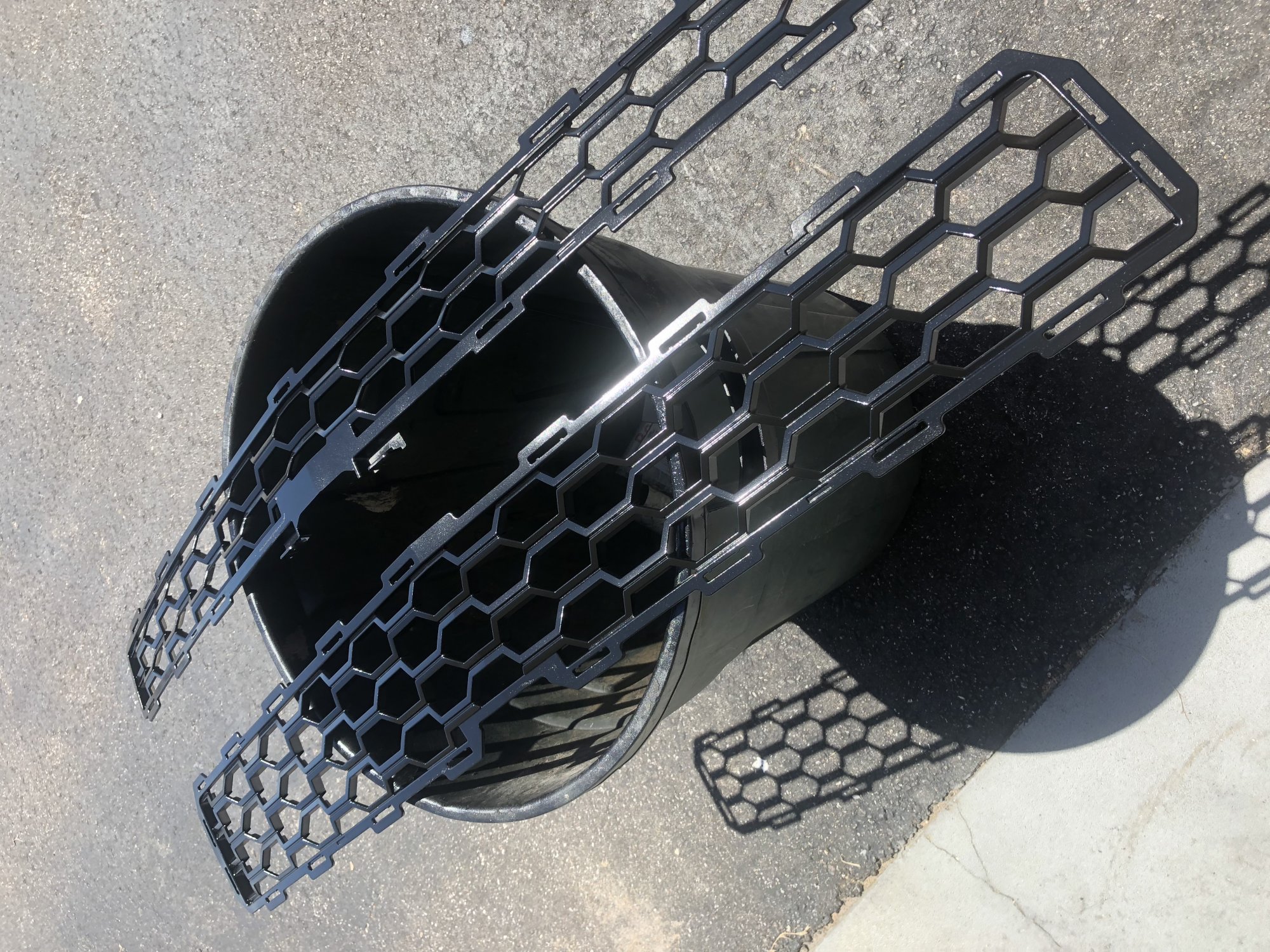

I rattle canned the inserts after popping them out with a semi gloss black paint.
3 coats did completely cover the inserts.
Don’t go overly thick and make the clips on the outside too hard to pop back in also...

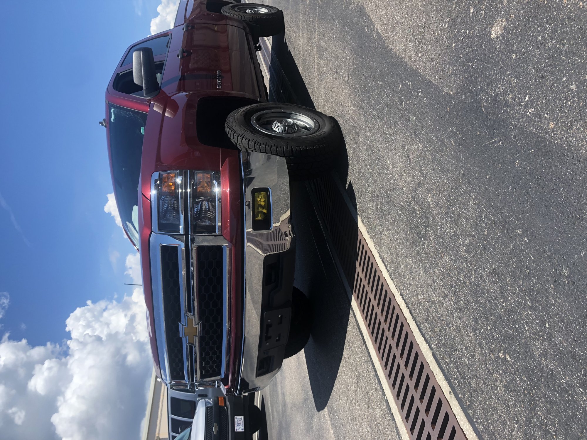

Maybe someone can help me figure out how to spin images, but here’s the final product
