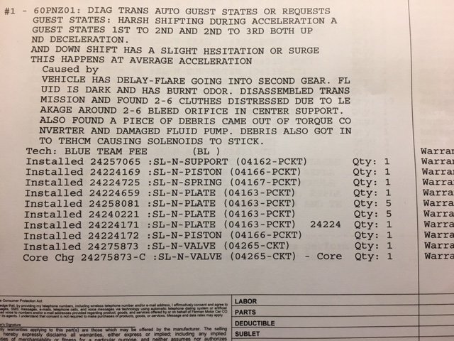

Finally got the truck back after 13 days. It is definitely driving much better. Here is what they found and what they did.
