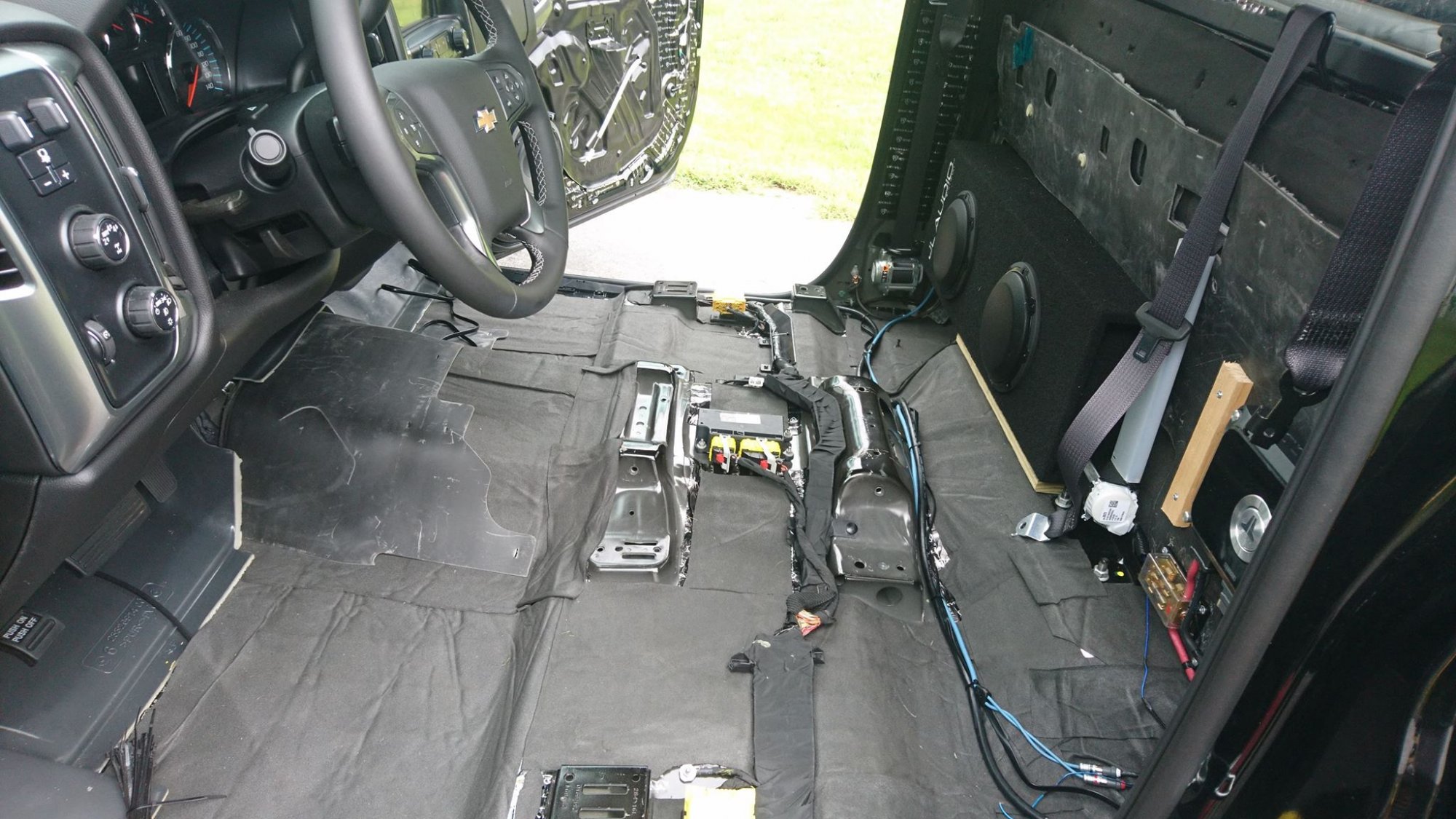

I have the same truck.  Im doing audio frog gs componentsran active.  2 sundown 6.5" subs. all ran off of an arc audio 5ch with mosconi 4to6 dsp

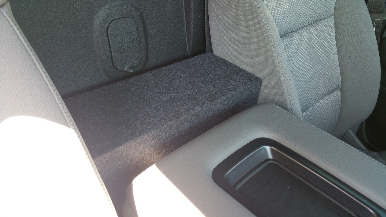

I took a Kicker Soundstage setup and made my own box to fit it in the truck. Only problem is the box hinders the full opening of the center console lid and the jump seat can not be used. Could have made the box different to make work with the center console better but im ok with how it is now.

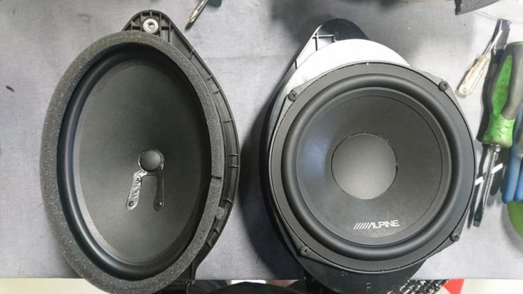

I have been experimenting for quite a while with my 2016 regular cab  audio system and am finally narrowing down what I am going to do. What you do depends on your objectives and how much modification you are willing to do as well as your budget and here are a few things I have learned that hopefully will help you in deciding what to do with yours..

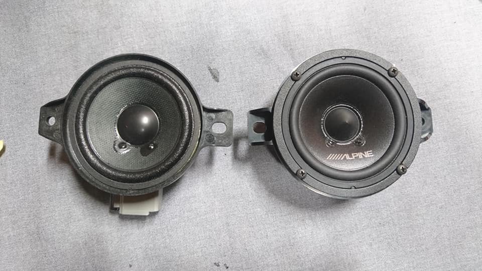

 Main thing I noticed was the lack of top end so I started out by replacing the dash midrange speakers with a good pair of aftermarket mini midrange speakers. Vocals/midrange were better but still lack of top end and no way to adjust level between dash mid/door 6x9 so they didn't blend well.
Next I tried a set of tweeters in the stock dash location with passive crossovers and actually hooked up the factory 6x9 to low pass on the crossover. Surprisingly the factory 6x9 played fairly well up to the 3500hz crossover point and it sounded much better than with the factory mid. IMO many people who are just not happy with the lack
of top end would be happy with this simple upgrade or going to a good set of 6x9 "components" fir better bottom end as well. If you need it louder a small amp would be in order and if you need better/more bass a sub would be the ticket for sure  (in that case you could save a few bucks and go to a 6.5" component set)
Unfortunately I am a bit more picky so I need more. Tweeters firing off the windshield in the stock location didn't have the best response so I took some double sided tape and experimented with them in the sail panels, on top of the dash and on the a-pillar at different angles. Sail panels are the least obtrusive and sounded a bit better than stock  location but not worth the effort for the small improvement IMO. On top of dash and a-pillar had better response but of course now they are more obtrusive and many may not like that.
Back to my being picky. My goals are to get a very good soundstage and imaging with smooth response and extended low end. I have the Alpine 10" Restyle kit installed now so I have some processing available and after getting everything dialed in as best I could with it's limited capabilities I can get a solid center image as well as wide stage but I had a compressed stage on the far left with a hole in my soundstage right in front of me. My guess at this time is that the left door mid way off axis location is the issue or due to limited tuning capability I am unable to get the response the same on both sides so more experimenting is in the works.

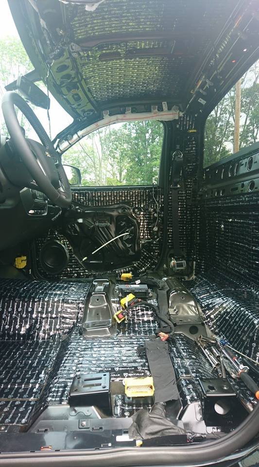

And don't forget  the dampening and sound deadener and all that stuff
