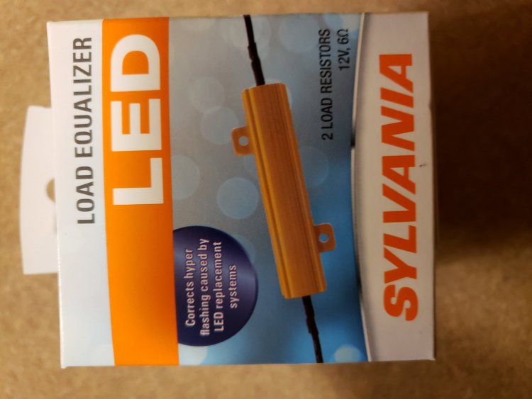

So I swapped my lt taillights for ltz taillights over a year ago. I used a harness from gen5diy.  Everything was working great until today.  I got a lamp out warning for left taillight.  Ohmed resistor had 2.089k ohms, obviously resistor is bad.  Went to autozone and got sylvania 6 ohm resistors and swapped out resistor.  Still have hyper flash.  Thinking I had got wrong resistor I swapped the resistor for one from my front ltz headlight that I got from @pgamboa still have hyper flash.  The lights in the taillight still light up and flash.  My question is do I have a bad taillight or am I using the wrong resistor?  Here is a pic of resistors I got. Any help would be appreciated. Also I put my stock LT taillights back on and everything works right.

You need (2) - 6 Ohm or (1) - 3 Ohm for the tail lights (because you have 2 bulbs).
If you took the headlight resistor, that’s a 6 ohm and why it didn’t work.

I had same issue and got my harness from same group.  You need 2 of those connected to fix issue.. Might as well get 2 extra for the other side as mine went bad a month after i fixed the side that was bad.

Amazon. 6-ohm 100 watt ones... but... they will not have a short lead soldered on...
I had the same problem a week after i bought my harness from gen5. He sent me 4 resistors. It uses 2 per side to SHARE the load. Mine dont even get hot anymore. I also made an aluminum mount bracket for them.
Ok so I will need 2 of them per side?

Paralell. Yes. So power coming in goes to both at the same time. Not through one, then to the other.

You don't need the BCM flashed, no dealer would do that anyways.  As far a resistors go, you need one 3 ohm per side, or two 6 ohm per side.
