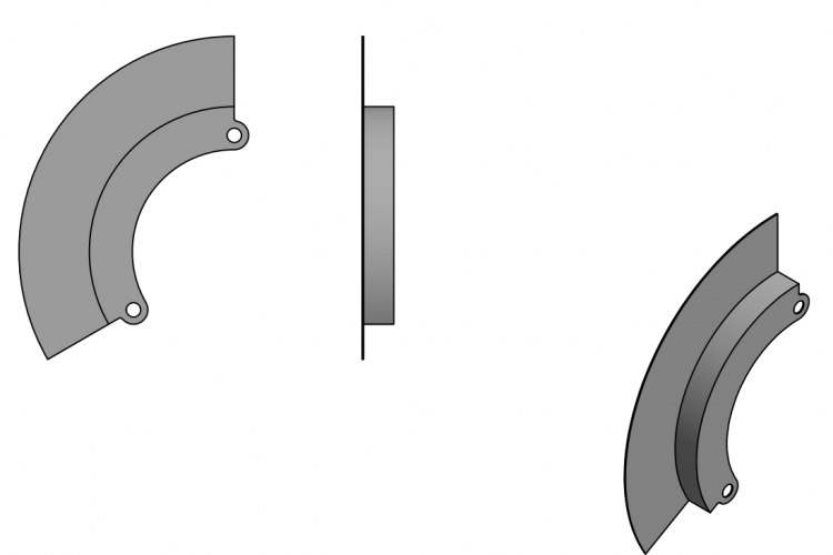

I need some new dust shields for my k1500 for 97.
It's the 3 bolt hub and it's mounted with 2 bolts, but I've been told that they are not produce anymore.
Anyone who knows where I might be lucky to find them.
They roughly look like the one on the picture.

looking on rock auto, it shows the dust shields (actually referred to as brake backing plates) at https://www.rockauto.com/en/catalog/chevrolet,1997,c1500+pickup,5.7l+v8,1031555,brake+&+wheel+hub,brake+backing+plate,1628
IMHO If the wheel speed sensor for your ABS remains intact without the backing plate, just rip off the part that is rotted out. I was lucky enough to just unbolt the 3 bolts for the backing plate on my old truck and remove the backing plate between the bearing and knuckle and throw them in the trash. For the rears I just cut them out with an air hammer since I didn't want to pull the axle shafts out to properly remove the backing plate. Since you have drum rear brakes you need the backing plate for the pads to work properly and be held in place. On rotors they are pretty useless for the most part.
