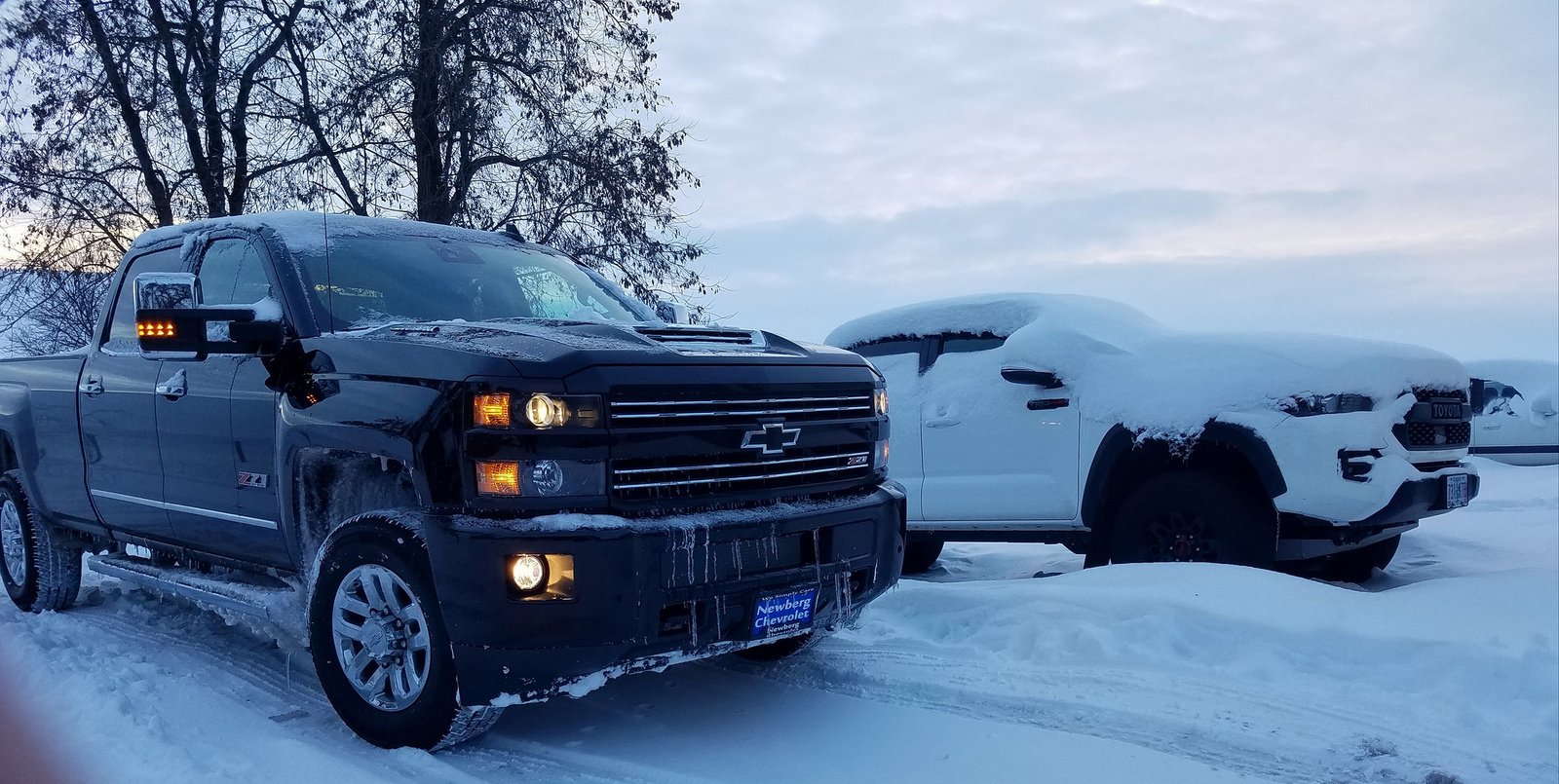

After breaking off a couple clips by hitting snow with the valance I removed mine completely. I can see with the shape of the Chevys trimming may be a better option. Only thing is I think mine would look better with the chrome center, so if a blacked out bumper wants to trade....
I cracked mine in the snow also. It's now in the trash. I'm not paying $200 for a new one. Looks better without it anyway.
I trimmed mine right away, I did it on the truck, just used the edge of the molded contour and trimmed it with an angle grinder.  It looks 100 % better and was free.

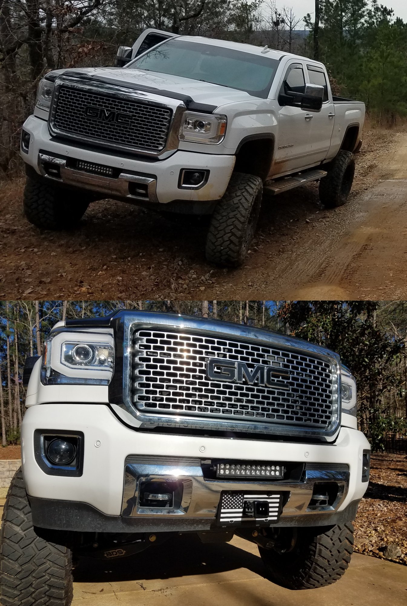

Mine stays pretty dirty, but these show how much more clearance you'll get just from trimming it. MotionMan did his while on the truck. I would save myself the time and do that if I could go back and do it again.

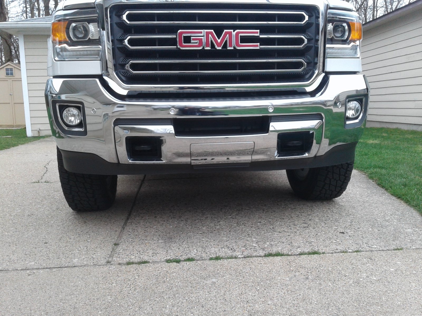

Thanks for all the info. I personally don't think the trucks look "finished" with the full removal. I haven't had any issues, but have thought about trimming mine.
Just take your time, I taped a line a little lower than I wanted then finished it off taking a little at a time, you can always take too little and work your way to where you want but you can't add material if you go too far.  I used a file and a sander to get to my final line and got a nice even smooth line.
I agree with you. I took mine off - sorry but the Sierra does not look “finished” with it completely off
it def looks like something is missing now. I may throw it back on
