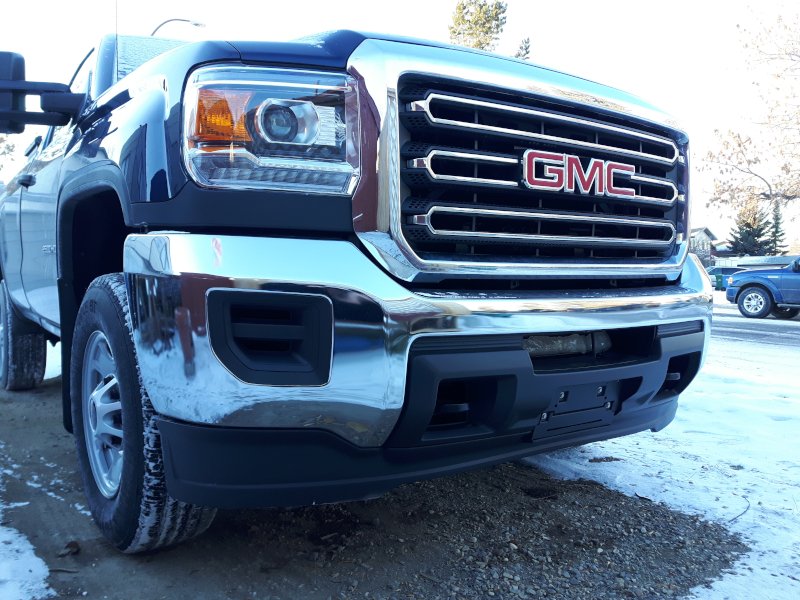

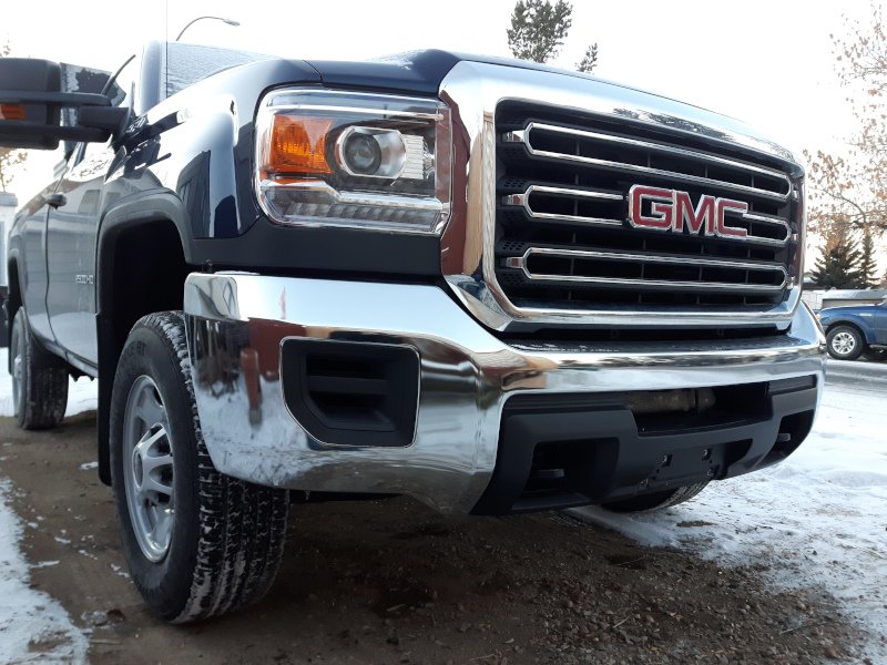

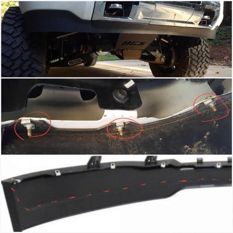

I never got any good head-on pictures beforehand, but this is what it looks like trimmed. There's also a picture of a few of the 10mm bolts that need to be removed. You can see how tight the workspace is for a wrench. In the third picture I've drawn a red, dashed line along the bevel where I made my cut. 20181030_215105.thumb.jpg.c1ed90f4c8085f312d021f1a4c0c87a2.jpg

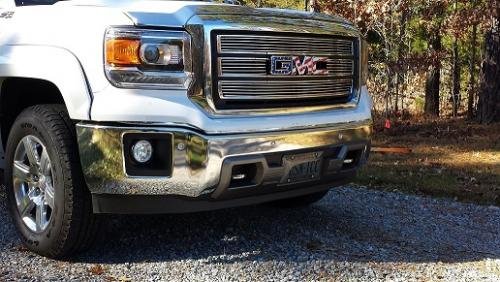

Here's some:
A couple more here:
Some examples in this massive thread too:
Maybe it's discussed a little less here, but lots of drivers have been doing the trim on the midsize trucks over on Coloradofans.com.  They have a tougher go, since it is difficult to access the bolt heads for removal.  Some just trim it on the truck to avoid the hassle of removal.
I'm not trying to suggest it was wrong of you to share your thoughts and experiences, but was simply pointing out I'd seen similar before.
Yeah, this one from your link is pretty close. None of these are the two I'd found previously though. They were great head on comparisons. Especially with lifted or leveled trucks, the open bolt holes show on the bottom of the metal portion of the bumper. Mine were visible even before lifting.
....I messed up and should have taken good pictures of mine with the full valance, with no valance, and with the trim job. Then all three could have been in one spot as an example. If anyone has all three, I'd appreciate it if you post them here.

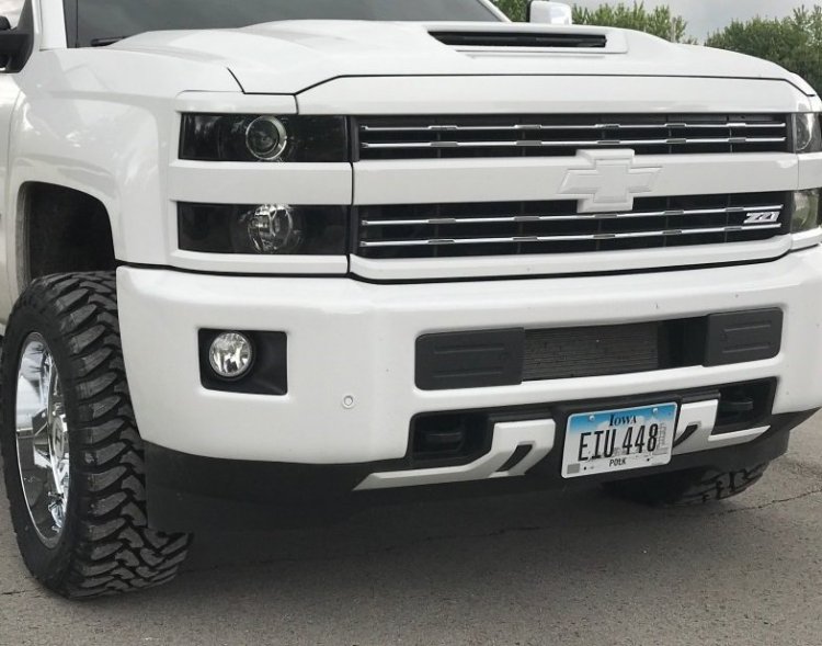

I am aiming for this look below, the only issue next was the license plate mounting I believe they are rivets. Another thread and discussion. I don't want to mess with law on a fix it ticket lol.
