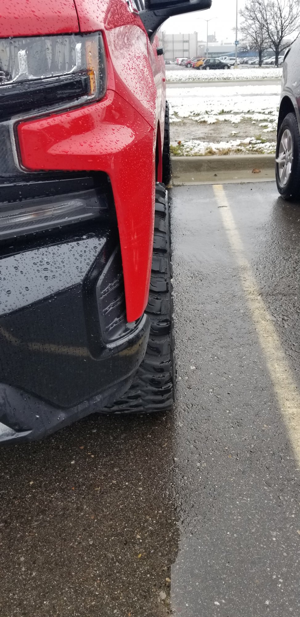

I did not recalibrate mine because it's only off 1 mph for every 30 that I am going so for example if my speedometer shows 60 mph, I am actually going 62 mph so it's not a big deal really.  I am running the size you want to use 305/55R20 (33.5x12.5R20) and mine does slightly rub at full lock but it's not that bad at all.  I have a 0 mm offset rim and if ur rim has a more positive offset then it may not rub at all.  Below is a picture of how far they stick out with a 0 mm offset rim.  Any other questions, please feel free to ask.

I am not running spacers.  My rims are 20x9 with a 0 mm offset.  They honestly stick out around 1".  The picture is a little deceiving because of the angle it was taken from.  Here is a better picture.  If you try and run anything lower than 0 mm offset on a 305 you will rub a lot.  Mine rubs very slightly at full lock but it doesnt really bother me.  Also, the width of the tire will definitely play a difference on how far it sticks out.  Some tires claim to be a certain size and they are not.  My Mickey Thompson Baja MTZs are 305/55R20 and they actually measure out to 33.5x12.5

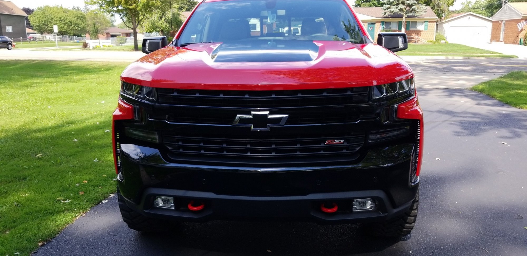

Let me know if these pics work or you want any different angles

Man, all you need now is red brake calipers and you would be all set.  Sweet looking truck,  thanks for all your help!

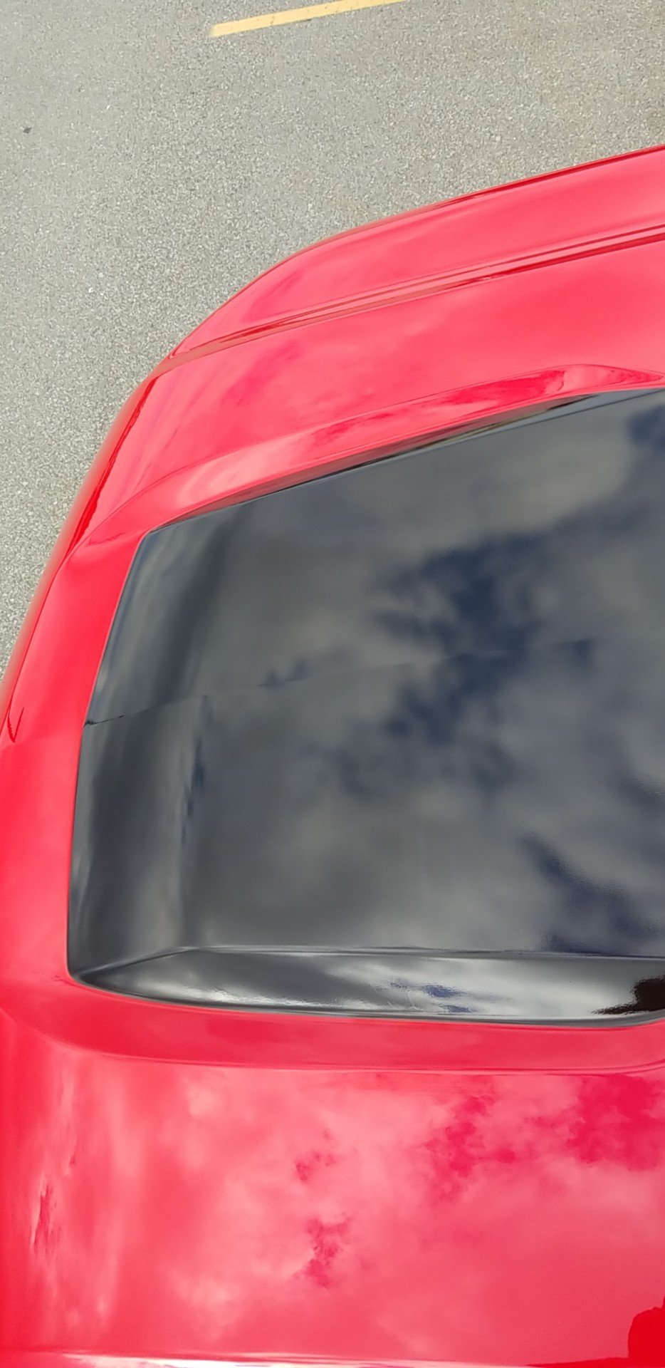

I like your black vinyl on your hood! Can u put a few pics of that on here?
Thanks!  Sure...I had a guy wrap the center scoop in gloss black.
