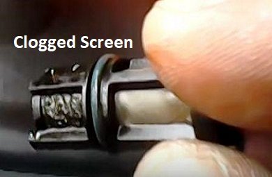

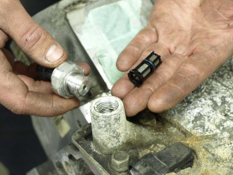

We didnt see no filter in the old valley pan or the new valley pan, but he said when he ordered the kit it said it was going to come with a low pressure oil pump from Amsterdam racing, so should we juat put the old high pressure oil pump ack in it. Thanks for the help.
When we looked for it on the old valley pan there wasn't one in there and also on the new one there wasnt, so would it hurt it to run it without that filter. Thanks for all of the help.
If the screen is not there, and you already replaced the oil pressure sender, and the oil pump - I would suspect that you have problems with the main bearings maybe? The low oil pressure needs to be addressed. As for the screen being gone, you might run into lifter problems. A friend removed his screen 6 months ago, no problems so far. If it were my truck, I would put a new screen in, and change the oil every 3K with full synthetic. On the other hand, cars didn't even used to have oil filters at all - but of course they didn't last all that long either.
