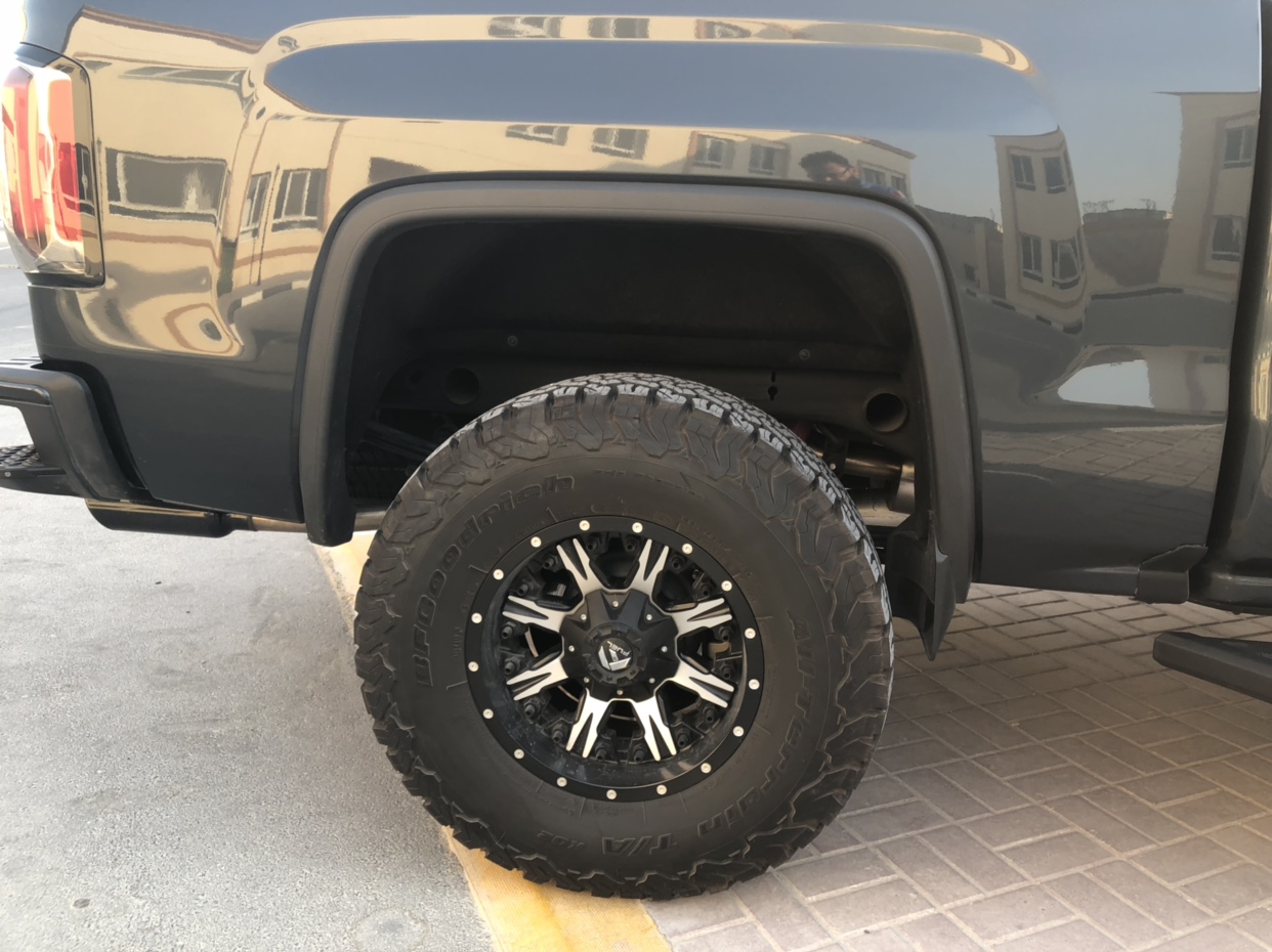

I have 17/9 fuel nutz on my 17 Sierra , I have 4 inch lift (readylift) I have slight rubbing when locking the steering to the left or right ( rubbing in the fabric covering the fender from inside ) which GM dealer ( who did the lift ) said I should not worry about it and actually the car now has like 4000 miles and I’m not bothered by that .
My advise check first the lift kit as it will determine which wheels you should get ( from backspacing ) point of view , mine is 5 and I was lucky as this the right backspacing for my lift kit as normally the lift kit will come with new control arm which decides how much back spacing required .

Pics!
