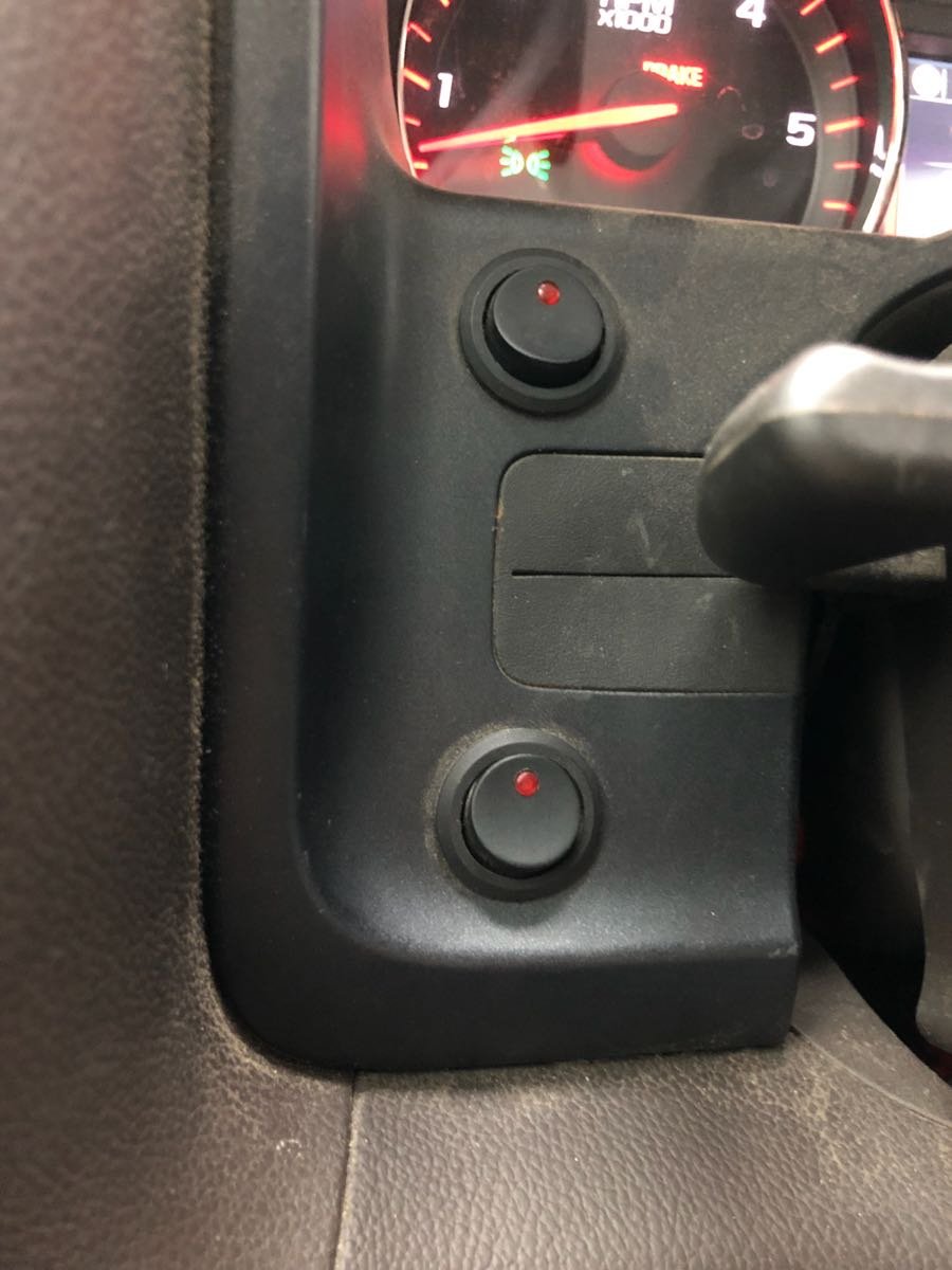

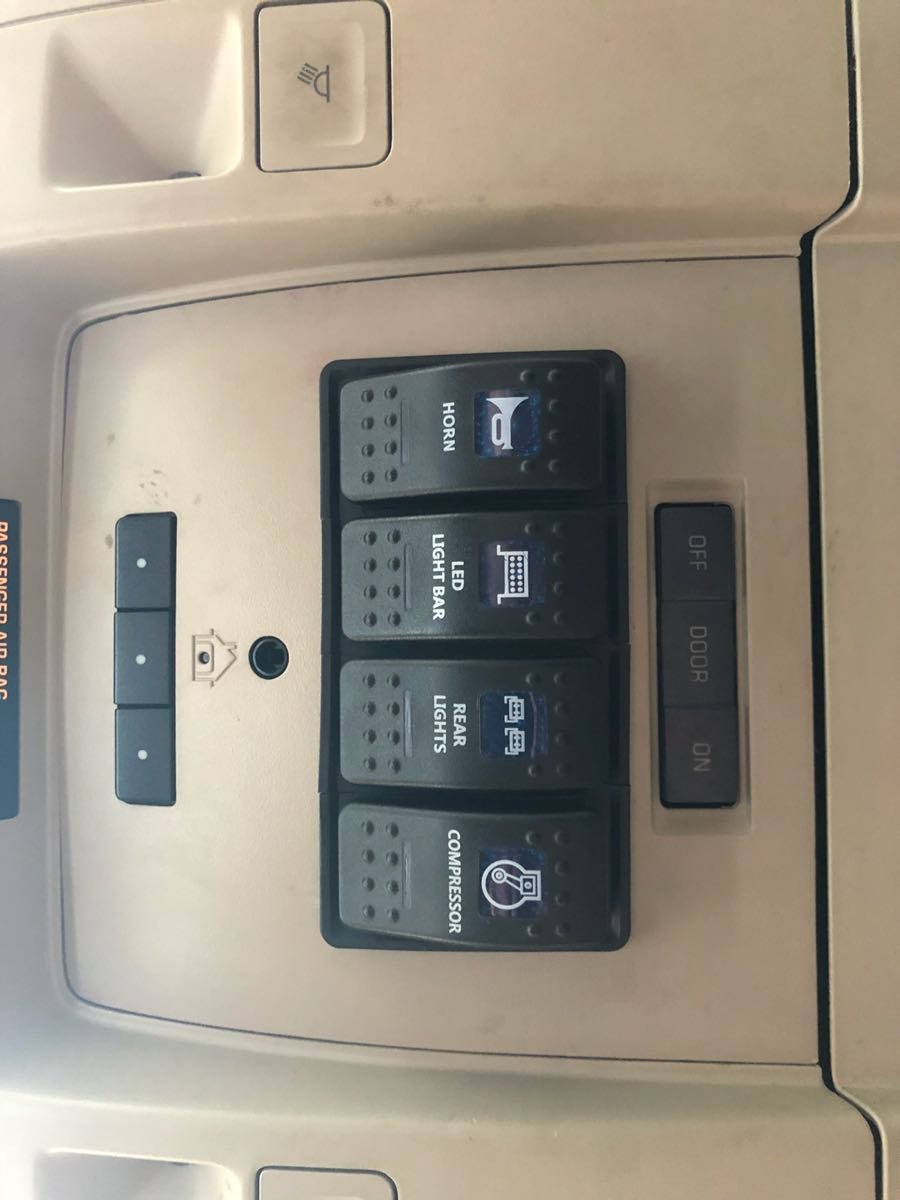

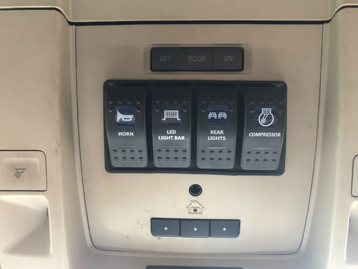

Here’s (almost) all the switches I have on my truck as of now. I plan to add more soon though. I two more hidden switches under the dash that aren’t pictured. The overhead console switches are labeled. The ones on my dash behind the turn signal connect my light bars to my high beams so when the switches are activated, my light bars come on when high beams are activated. The a pillar switches are to turn on my roof mounted light bar and my emergency lights. The switches on my left side bed rail turn on my cargo lights and my air compressor.  4319E49B-0FB6-4F71-9EC4-55CE1636F14A.thumb.jpeg.b0bed50d4b4b6f072dd31b43f9971bbf.jpeg3F44A005-F153-4065-9133-459D18E15F64.thumb.jpeg.2d911ca587bad02667942e3c22388bdc.jpeg13FFE4AF-DB56-4768-A69C-B9A8D2685E55.thumb.jpeg.7287ad9bbb5aefe3a7a463c6c37ac27b.jpeg7AF68900-4314-4964-B204-DA177E8CF866.thumb.jpeg.9ac9e7ac1e7ae7ca93abb21b945d7f88.jpeg
