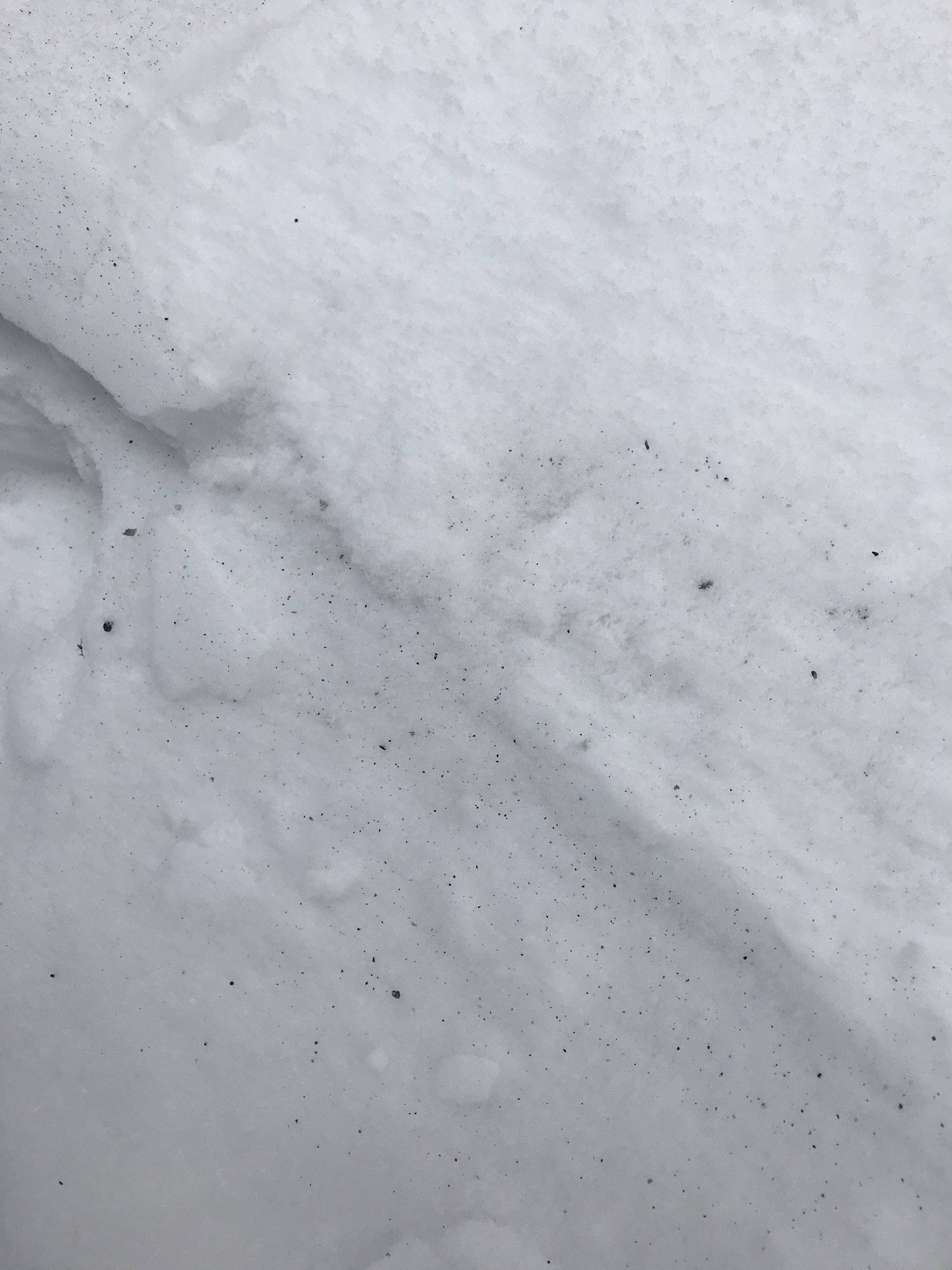

2014 Silverado 5.3 80k. Wouldn’t start the other day when it was -30 F. It acted like it was flooded. Couldn’t mess with it for too long since the battery went dead(original battery). Got it going today with a jump from another truck and a lot of cranking since I think the plugs were fouled. It runs great now, but I saw all these deposits in the snow? Is it just carbon deposits, and do you think that could have been partially what was keeping it from starting? Maybe plugged injectors?
It was probably the flapper valve frozen shut

Good to know and yeah it was frozen shut. I tried to turn it with a big pliers, but I couldn’t get it to budge until the truck had warmed up. Same thing with a 2015 Sierra I compared it too. I thought maybe if it was froze shut that could have been what was keeping it from running, but once it was warmed up and able to move it stayed in the same spot as when it was frozen. So it’s default position must still allow adequate exhaust flow. I left that detail out since I think that rules that out for what was keeping it from starting, unless I’m wrong.
After 4-5 years and 80k there will no doubt be carbon buildup just about everywhere.
Especially on the valves and in the exhaust system.
These DI engines spit out "normal" black soot on cold startup.
Could have been your flapper valve frozen. This is a common issue in sub zero temps.
Yeah but if there was ice blocking the default passages in the closed flapper position the truck wouldn't have started. Water is a byproduct of combustion.
